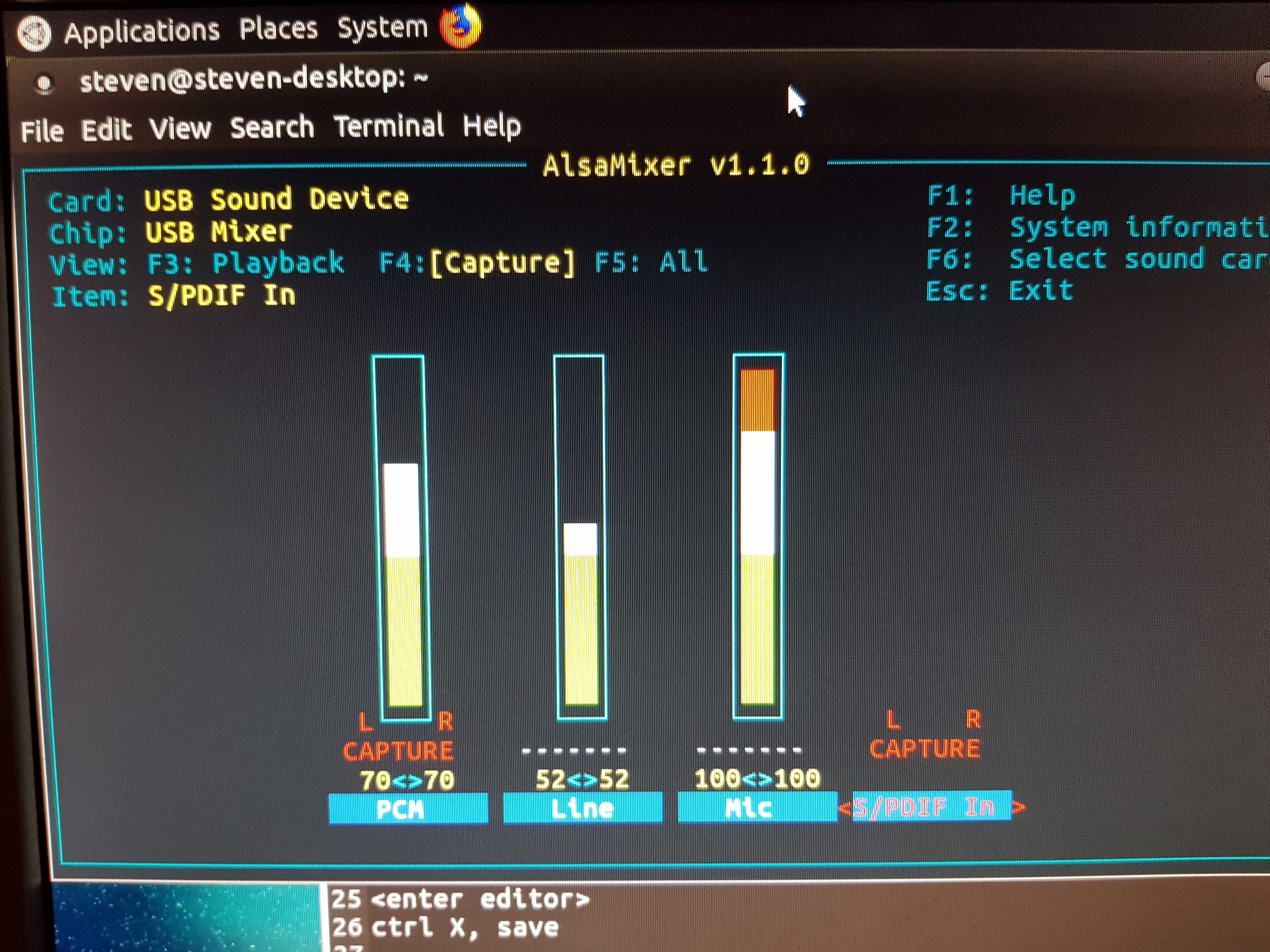

In alsamixer, you can press F4 to view only the capture (e.g. recording) controls for the card. Since you have both an input and output spdif connection, this will prevent a mistake where you change the output spdif control when you wanted to change the input spdif control. Otherwise, you can look for the word "CAPTURE" below the control.
The control "PCM CAPT" might be a selector for WHICH input is selected. Can this be set to something other than "MIC"? I would set it to the input that you are trying to record from.

Thats the think I don't understand how do I switch the value of PCM?
Using arrow keys.
Just look at the picture - what is your PCM Capture value and what value did I write in my previous post?

I think the last picture was not so clear as both the Mic and spdif were red. Below the picture of the Alsamixer of the situation I test to get spdif in to work
Unfortunately no sound. Are these the right settings in Alsamixer?
As I told I also tried line in (togling this to capture with space) but this doesn't give sound either. I tried arecord -L to find the line in but for the USB card the output makes no difference compared to aplay -L
Your "PCM Capture" selector on the first picture is still at Mic, right? Then your input is microphone. You have to change the selector using arrow keys to "IEC958 In" (IEC958 = SPDIF), as I told you a few posts before.

To be honest I have no idea how I made the channel PCM capt and set Mic in it.
Default value?
The second picture I made later doesn't show this channel. Can you please clarify this?
Very simple - your first picture shows the first alsamixer "tab", your second picture the second "tab".
I thought it would be simple and now I understand the capture in, thanks for your patience. Analogue input using the line in was succesful and the filter is doing its task. Unfortunately the SPDIF in still doesn't give any sound. So I am afraid that spdif in combined with audio out is not working (apparently other soundcards have the same problem).

Again, the PCM Capture Source must be changed to "IEC958 In" to record from the SPDIF input.

I asked the supplier of the soundcard for advice and got the reply: 'You need to install the drivers'. There is a small CDROM with the card. PCI cards and CDROMS are scarce these days but I will give it a try.
First, put here the amixer output described in my post above when your spdif input seems not to work.
Since you do not show your ecp files and there could be something wrong with them, why don't we try to simplify things and just try to pass the audio thru the device, input via spdif and output via channels 1 and 2 (these are used for the woofers).
What happens if you run this:
Code:
ecasound -B:rt -f:16,2,44100 \
-i:alsa,iec958:CARD=Device,DEV=0 \
-o:alsa,front:CARD=Device,DEV=0
