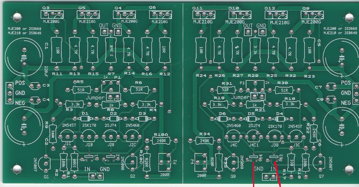

Hey guys, regarding Jack's rev2 PCB, what is the jumper below P1/P3? Are those to connect the signal & power ground? Is there benefit to short it or leave it bare?
Those red lines are a bit misleading 😉 If you are asking about jumpers under P1/P3 then yes - they are used for connecting signal and power ground.
Those are for surface mount devices if you can't get the legged ones!
Sorry or the confusion guys, I reused miklos' photo. 😀
Thanks for the verification on the signal/power ground connection.🙂
