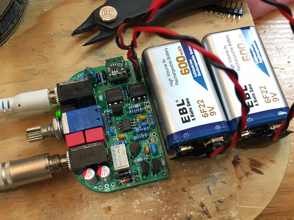

The amp works - I got the Li-ion 9v hooked up with proper connectors and it seems like the jacks need to be plugged in for the LED to come on? Listening to first song now. Very nice - just about the perfect gain at 2x for my DT880-250's.
Let me burn it in and listen to some more songs and I will give a report how it compares to my class A head amps.

Congratulations on your build! 🙂 Sorry about the delayed reply, I'm just now getting back to the computer. The symptoms you were having at first are what happens if the tiny comparator chip on the little PC board doesn't turn on. If it were still dead I would have had you measure voltage at the points in the first two diagrams below. That part of the circuit is referenced to the negative power rail rather than ground, so your negative meter lead would go were the purple circle is (one end of R5) and the red lead where the blue circle is. When the comparator turns on that blue circled point is brought down to the negative rail, and then all the stuff in the series string turns on. Both SSR internal LEDs, the front panel LED, and the current source.
With the batteries connected (charged up, of course), the front panel LED should light any time the switch on the volume control is on. When you rotate the control all the way counter-clockwise and turn off the switch the front panel LED should go out.

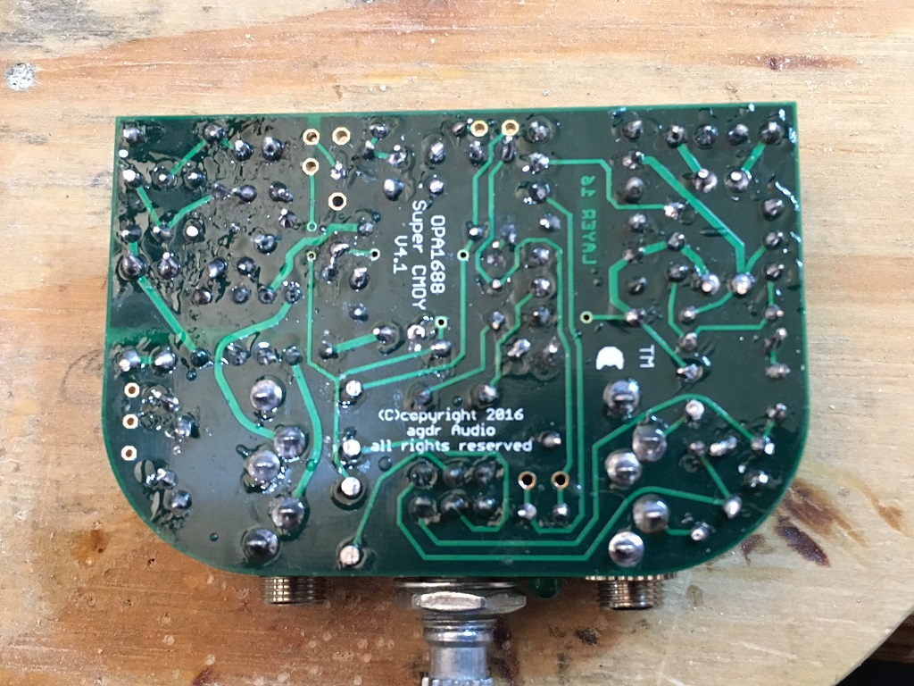

I see one problem though, in looking at the photo of your PC board. 🙂 For a gain of 2x there are two jumpers (just pieces of wire, cut-off resistor leads works fine) that have to be installed where the yellow circles are in the 3rd picture. As you have it right now you are getting a voltage gain of 1x, but it should have the capacitors installed differently for 1x to give you good phase margin for capacitive loads.
SO... first thing to decide is if it is loud enough as you have it right now, or if you need it twice as loud. Sounds like 1x here is working fine for you, which doesn't surprise me given the high sensitivity of your headphones. If you do want 2x gain then install those jumpers in the yellow circles and it will become twice as loud. That upper jumper goes from the hole where C13 would have been to the installed lead of R6 next to it.
If however you like the 1x gain you have now, you first need to remove C7 and C8, those blue 47pf capacitors. They are only used for gains greater than 1x. You can unsolder them just by heating the lead on one end and pulling the part up on that end, then the other end. Or you could take your flush cutters and cut the part off at the leads. 🙂 Then once C7 and C8 are out you would need to install C13 and C14, two 1nF capacitors. I think we included those with yours in case you decided on 1x gain, but I can't remember. If not just let me know and I'll send you a couple. And that is it! Once those capacitors are in you are done. The purpose of the capacitor change is to prevent any chance of oscillation with typical headphone loads.
Hey one question, I see something green where R3 is at, near the back of the input jack, between the jack and the edge of the board. I just noticed that R3 and R4 are resistors that Digikey doesn't have. I'm guessing you put two in series there to try to make the 2.7 meg. It is important those resistors (R3, R4, and R5) be exact. If they are off by just a little bit it will mess up where the comparator turns on and off. That could be part of the trouble you were having. I have all those resistors here. I can send you two if you don't have the correct values in there, the 2.7 meg and 332K, both should be 1% tolerance or better.

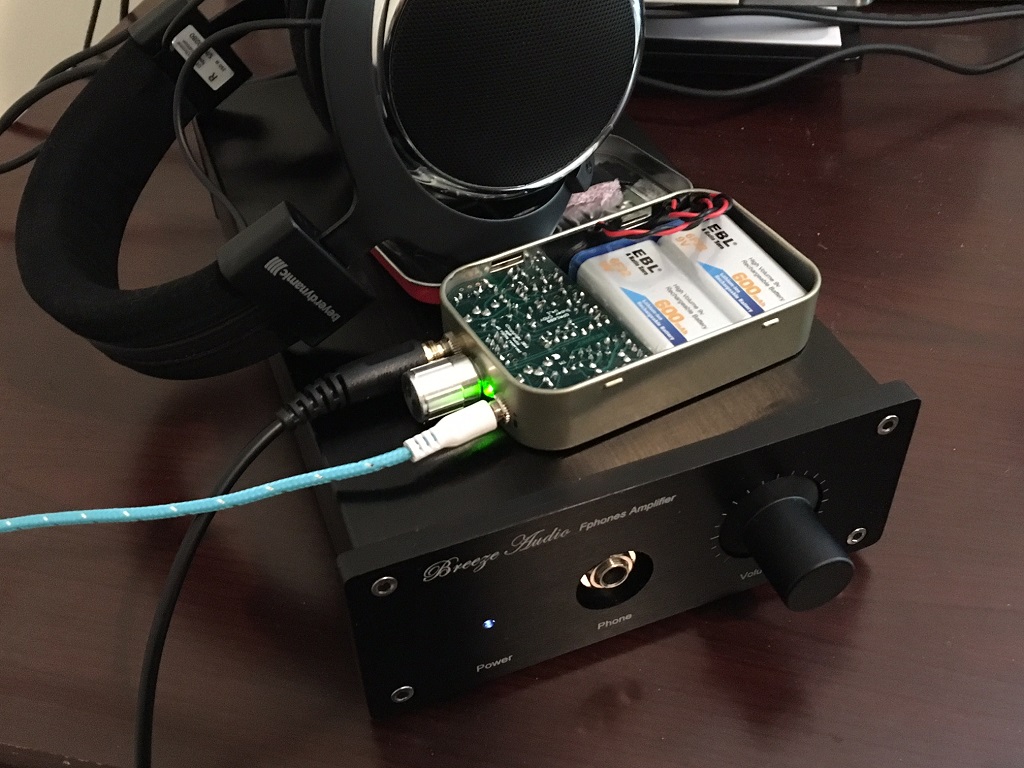

Thanks for the tips. I just got it boxed up and it's working fine when powered from a DAC but could use more gain when fed by my iPhone. So I think I would like those jumpers. Funny thing is that thought 2x was not enough so I installed smaller R8 and R9 values (330R since I did not have 412R) and of course, there is no difference. I guess I will just install the jumpers and see if it is now too loud (maybe 4.5x?). The amp sounds really nice - surprisingly powerful and clear little package.
I actually used 4 resistors in series to get exactly 2.7Mohm and 330k instead of 332k - hope that is close enough for the comparator. I think it did not turn on before due to old batteries or a loose connection between the battery and the PCB at the header strip connector I installed. Seems ok now and turns on,
Here is the amp sitting on top of my single ended Class A dual JFET amp (yes, just two transistors in the amp!). This amp is currently my reference amp as it has a very clear sound, is super quiet, and has a very powerful and articulate bass. More info on this amp here:
