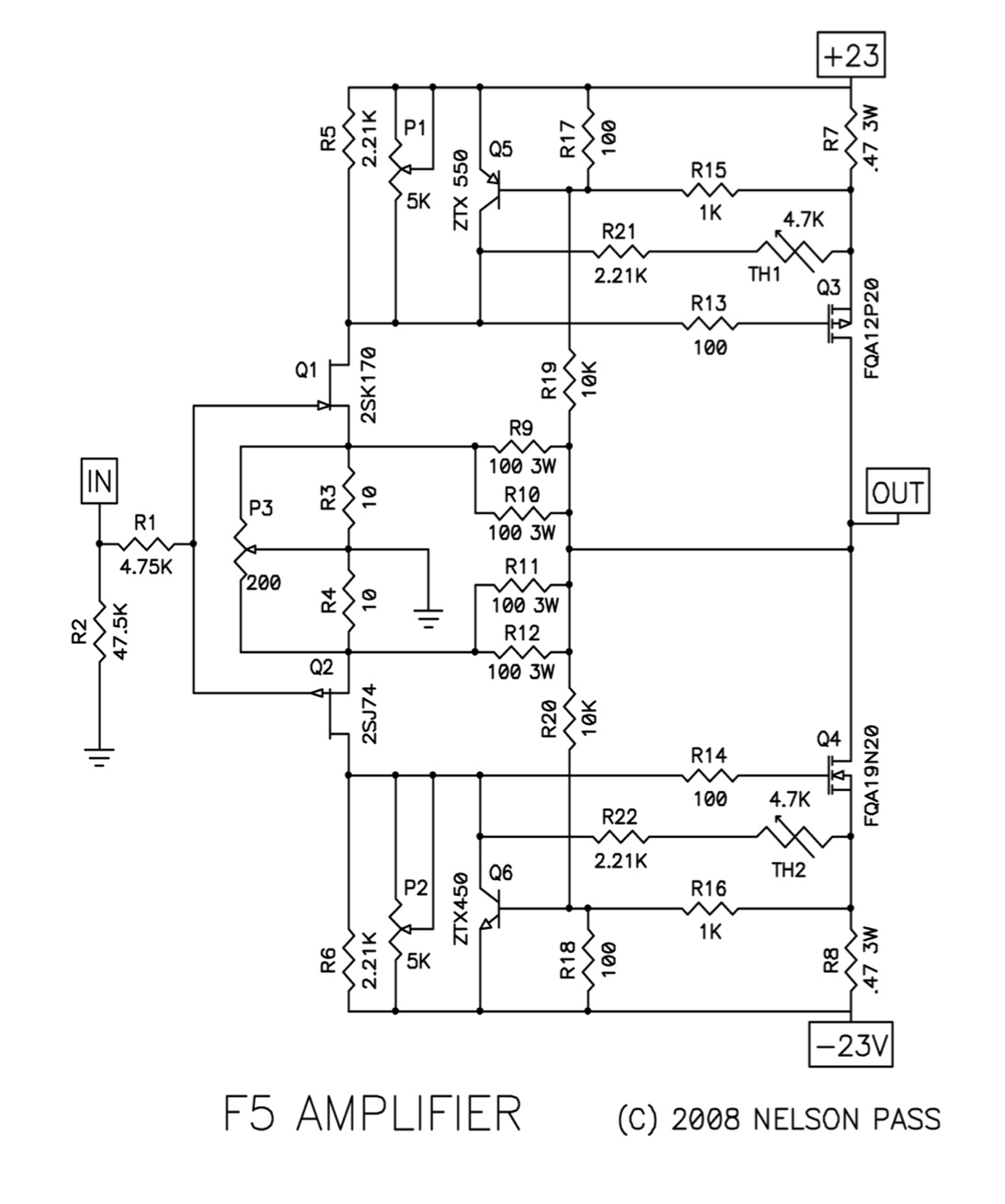

F5 - smoked R13
Hi all, after nearly four years of regular use, my F5 let out a soft, high-pitched hum on startup, then let the smoke out. I immediately turned it off and found that R13 burned up. Nothing else is visually wrong.
The only recent change made was a speaker protector board that was added a few days ago. It ran just fine for several hours of use after the board was added.
I'd appreciate troubleshooting tips from the experts here -- thanks. 🙁

R13? The 100R mosfet gate resistor?
pull out all semis and test them
while they're out , check resistors
replace what's burned , repeat proper biasing procedure
check for burs on heatsink , be sure when tightening mosfets to hsink
- easiest way to fix the amp is - take it and fix it

well , you have 2+2 important transistors per channel , and +2 not so necessary ones
is it hard to check them all ?

Yes it is hard, and it heats everything up unnecessarily. I don't have transistor test equipment other than a 9v battery and a resistor.
It might be better to build a new board if there no way to pinpoint what went wrong.
well , then it's all up to luck
maybe is just R13 and Q3 , maybe not
to save yourself (amp, actually) from some possible smoke ,after changing R13 and Q3, back down drain pots (biasing) and start from zero current
