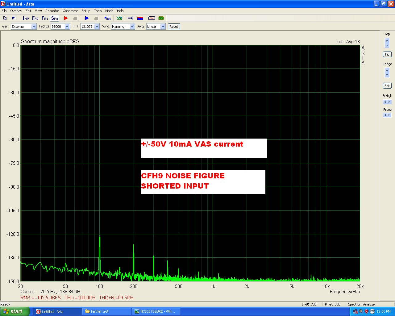

CFH9
What i have test up to now.
Power supply=+/-50V
VAS current=10mA
Idle current=40mA
Offset=0mV
No zobel!
Picture 1 amplifier as it in the previous test.
2)Without on board power filter caps.
3)Without on board power filter and input filter caps.(please reed the AKK as ALL)
4)Only 100uf on board power filter caps installed and not connected to GND.(50uf rail to rail)
5)Only 100uf on board power filter caps installed and connected to GND.(2V A.C OUT/7R).
6)Only 100uf on board power filter caps installed and connected to GND.(20V A.C/7R OUT).
7)Noise figure when amplifier input connected to P.C without signal.
8)Noise figure when amplifier input is shorted.
9)2x100uf INSTEAD OF 4700uf ALL smd 100nf NOT INSTALLED
10)The position where 1N4001 installed.
Power supply=+/-50V
VAS current=10mA
Idle current=40mA
Offset=0mV
No zobel!

Long thread, so I'm not sure I am reaching the correct conclusion by saying that:
all this problem was down to bad layout of the return currents to the main decoupling ground?
i.e. is it a grounding problem?
Wow. Dang!!!
You are the master detective and pesky B@stard killer!!!
We all eagerly await the final summary of critical changes to make it so. Sounds like big rail filter cap causes problems? Don't understand that as it could as well be big cap from PSU upstream.
One more question: does this mean that the main noise is the 100Hz ripple from PSU so PSRR is -120dB? Then True noise floor without power supply ripple is -150dB??? That's astounding.
Hooray, the amp is ready to play some Frank Sinatra for Christmas!![]()
