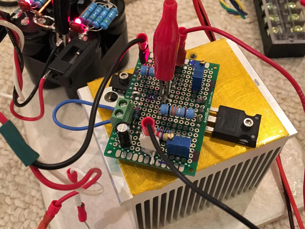

First try at DEF

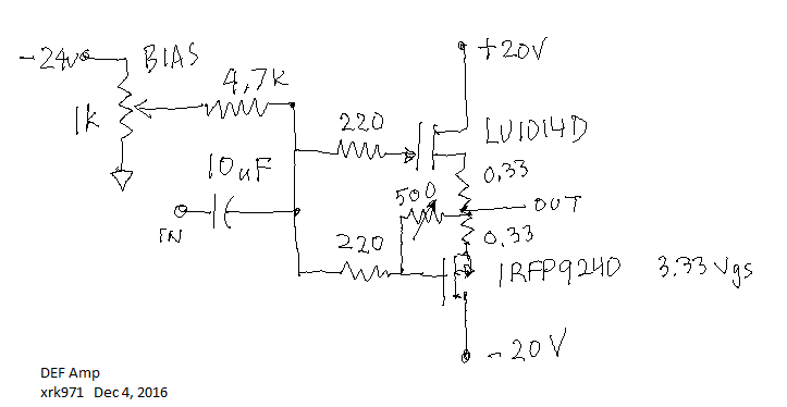

Veroboard P2P of DEF using LU1014D and IRFP9240. I am using a 500R pot between gate of P chan and output and 1k pot to set negative bias from -20v rail with 4.7k from bias source to input gates. 220R gate stoppers on both gates. 0.33R degen resistors on both sides. It doesn't blow up but I am running out of range to set bias to high current and DC offset to zero. I got it to 2v offset and only 72mA before hitting the stops.
Too bad I have to leave lab now for more travel so cannot debug until I get back in a few days. I think it will work though. Maybe I need that cascode but am not smart enough to design it.
Here is what I have so far:
Here is schematic as built:
Veroboard P2P of DEF using LU1014D and IRFP9240... Maybe I need that cascode...
Perhaps try something like in the attached schematic, which uses the ZV9/F3 cascode. R9 should be a trimpot. I have the bias at 1A and the LU1014 has about 10.4V across it. Of course, note that this is a model only, so actual required values may vary dramatically. I won't have a chance to test the real thing for some time.
According to the LU1014 model, having -4.5Vgs or so (which one would need for the IRFP9240) would require Vds in excess of 20V, so you'd be dissipating 20W or more through the tiny LU1014. Possibly not safe long-term. So, perhaps the low-Vgs 2SJ201 is a better match than the IRFP9240.

Thanks for the circuit and sims. My Vgs on 9240 was measured at 3.33v so not as bad.

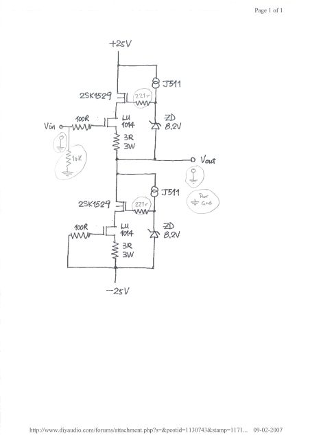

I was wondering why don't we just make it a symmetric circuit and use IRFP240 and LU1014 on top and bottom and in that way, the bias is exactly matched automaticallly. You would end up with something similar to what I am doing with a headphone amp.
Just use IRFP240 and adjust Zener to get appropriate bias current.
Yes, I only ask because since I will be adding an IRF240 cascode and the concern that Needtubes said about too much dissipation when matched to single IRFP9240 on bottom, it occurred to me that if the bottom half was same as top half, we wouldn't have this Vgs disparity. This then reminded me of the other thread. So is there a benefit to using a n channel JFET on top and P channel MOSFET on bottom vs n channel JFET and N channel MOSFET on top and on bottom. Would the lack of symmetry of the DEF have a different sonic character? More H2 vs H3 whereas other way around for symmetric top and bottom?
