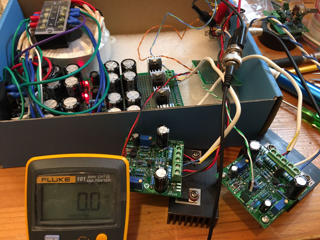

Works well now
I changed R2 and R3 to 47R now (33R was too small and did not have enough bias). With 47R max bias current is about 110mA so if you need more maybe 57R or so would be better. DC offset is very stable within 3mV. I got rid of the cross feed filter and am using a twin 50k pot wired between the input RCA jack and the PCB. The PCB is using 100k at R5 and I am running 100mA bias current (1.00v across R13).
The volume is now very good - formidable level and too loud at the max level when driven by my iPhone when using my Sony MDRV6 cans.
Noise performance is excellent, with no input, the headphone jack out measures 0.0mV AC with my Fluke 101. Cannot hear any background noise at all. However, when turning the volume knob, I can hear scratchy sound - not terrible. I soldered an earth ground from IEC socket to the shell of the pot and this got rid of the slight buzz/hum that was present at mid-volume.
I have spent about an hour now listening to various tracks. I really like the sound. Very clear and very transparent. No signature of its own - just good music that comes through as it should. One of my favorite test tracks is Nils Lofgren's "Keith Don't Go" - shows excellent articulation of transients and highs with acoustic guitar. Stand up bass from jazz trios are excellent: very clear and articulate. Piano is crisp and undistorted.
This head amp is a winner! Works fine with a 7815/7915 fed with a CRCLC supply.
I can't do an A/B test but I think I can hear the qualitative difference between a JFET front end and a BJT front end. They are both good, just different.
Here is a photo of the output noise test with 0.0mV AC.

wow! thanks X, really nice work and trouble shooting/tryouts. glad you like it.
this HA with Nazar PSU would be something i guess. have you ordered PCB's for the Nazar PSU?
that scratchy sound would be from pot, my guess... Try "dipping in IPA and vigorous rotation routine"...

Just to make some things clear:
- 50k volume pot is a bad idea. It puts max. resistance of 12k5 in series with the input, so 10k volume pot is a much better choice.
- Use R5=100k only if you want to use coupling cap. R5=100k enables use of a small coupling cap (1uF) so you can have a good quality cap at the input without having to pay too much for it. High value of R5 will (together with using Vbe/hfe unmatched BJTs) cause input DC offset that will manifest as scratching sound when turning the volume pot.
If you are not going to use coupling cap make R5=22k or lower (even 10k is OK).
So, the value of R5 will depend on how good are your BJTs matched. They are cheap and abundant so it's not a big deal.

... Since 50k pots are all I have at present, what should I do?
Get some 10k pots. IMO 50k is too much for serious audio - it will either make a strong low pass filter with FET's parasitic capacitance or modulate the base of BJT.
