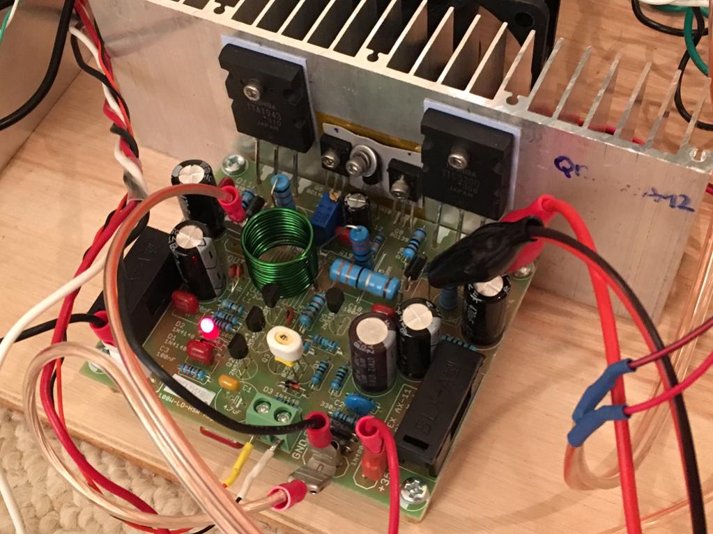

AX11 Bimo Mod First Sound
I couldn't wait for the NJW's to arrive. I had some 2SA1943's and 2SC5200's lying around (genuine Toshiba). So I proceeded to install the outputs. I swapped one of the 1N4148's (D2) with a red LED for power on indication. It is singing now but the bias adjustment on the Vbe multiplier seems to be off. I can adjust bias current but it bottoms out at 486mA (as measured with probe at R22 - the 0.22ohm, emitter resistor). So it is sort of running class A with lots of heat output so I added a fan. I am using BC546C as the temperature compensation Vbe multiplier. What values of resistors do I need to change out to get the range to go lower?
Currently running 35v rails. Bias is rock steady at - so the BC546 clamped to heatsink seems to be working. DC offset is -23mV (even though I matched the Hfs of the input BC550's).

the following was advised regarding this amp by Bimo and Andrew T.
Use Either of
1. D1+D2 (default)
2. Led+D2 (R4=TBD, R6=TBD)
3. Led+Jumper (R4=10k, R6=330)
So its better to use D1+ D2 or Led +jumper with R4/R6 changed.
reg
Prasi
Doesn't R14 and R13 control the bias adjustment range as those are the upper and lower resistors in the Vbe multiplier? R4 and R6 control the CSS current - which, I am not sure if that affects the bias current.
ok, i just saw the red led being used and i remembered the advice. may be b Mr. Mile or Bimo can advice on suitable values for R13/14 for the BC546.
