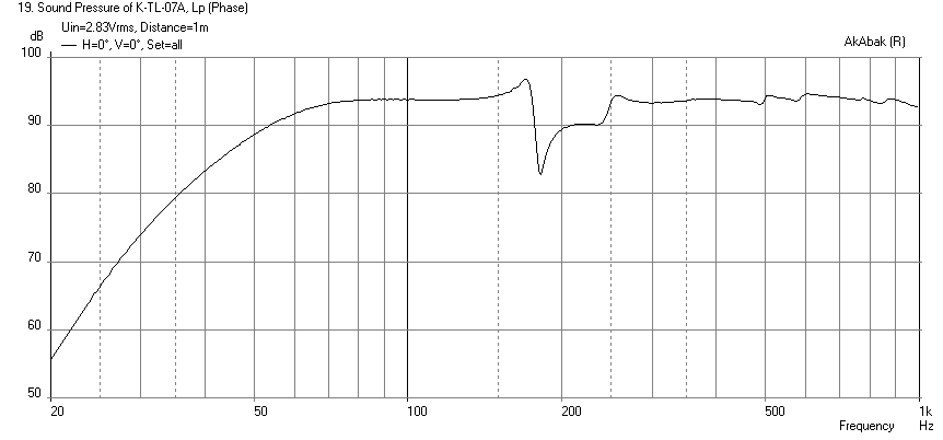

The parameters look at first view to be ballpark for a Karlsonator. I would think something about this size would be pretty close, perhaps a bit smaller. Beyond that you'd have to convince x to run his akabak sim.
This PAX-A16 can work well in a Karlsonator and achieve great sensitivity - however, it comes at a price of a large box as the Vas is so big. With a 0.8x scale in height and depth and 0.7x scale in width, you can have a 94dB sensitive speaker with a very gradual deep "pro audio" extension. The F3 if about 57Hz, but the speaker will sound like it goes deeper as the falloff is very gradual. F10 is 40Hz - so there is nice extension there.
Here is predicted frequency response:

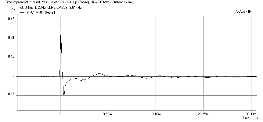

Predicted Impulse Response is pretty clean:

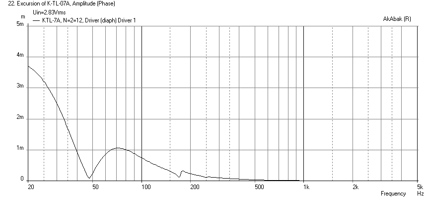

Here is the cone displacement - need to watch for content below 30Hz and use a high pass filter if such content exists to protect cone:
There are very few simple full range speakers that can reach 94dB sensitivity at 2.83v and 1m with an F3 of 57Hz. You should build it if the size is not an issue for you. This is assuming the speaker sits on the floor away from walls and baffle step loss is already accounted for.
