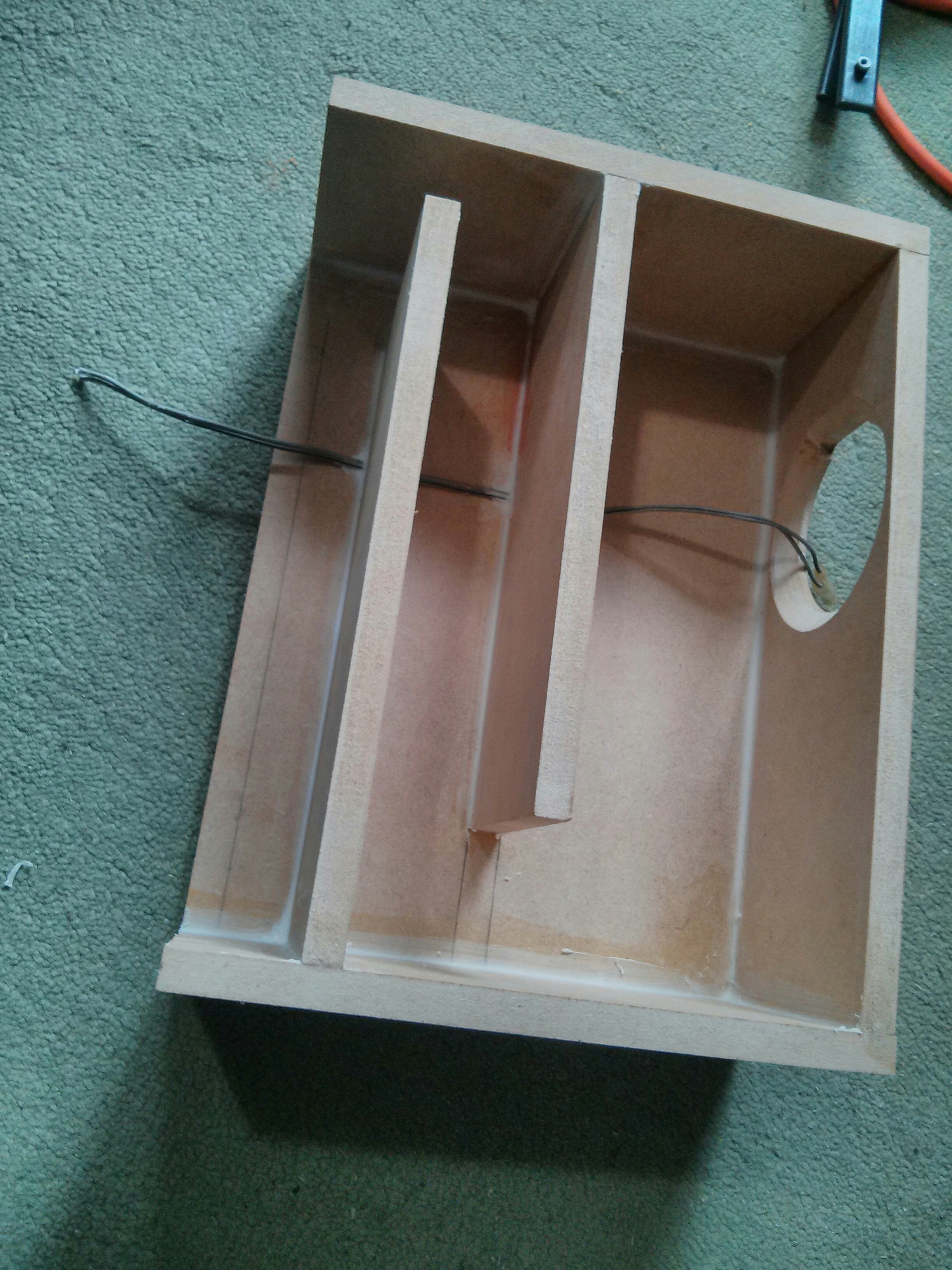

I'm part way through building these. At the moment, I'm trying to juggle fitting internal panels, felt and wadding and wiring to the driver from the rear.
Mostly I'm concerned about the speaker wiring. Trying to decide whether to groove a side panel or the top, and run it under the felt. Or run it down the line... Or drill holes through everything...
Then, the felting. The final bend has one inch height with half inch of felt to be installed, whilst avoiding the speaker terminals etc.
Is there a usual order to approaching this?

I'm running the wires along the side panels through grooves in the dividers. Will use decorators caulk or sealant after each panel is fitted and to seal the wiring in.
Speaker binding posts will sit about 1/3 way down the back so they're out of the corners I need to felt.

Hi Dave, thanks for advising.
I'm hoping the small size and bracing inherent in the labyrinth will help. Would applying a bitumen based damping sheet help? I have some quantities of dynamat and dynamat extreme lying around.
Terminal cups would make construction easier and maintenance a little more feasible. They seem bulky though. I was concerned at pinching the 25mm line further. (prior to your contribution I hadn't known to search for "terminal cups". I've found some 20mm deep/slim? on eBay).

12mm ply is about the same as 15mm MDF (MDF has some other issues besides less stiff). If you use 12mm it would be like using 9mm ply, i don't know if that is enuff. So if you use MDF use 15mm.
I would not worry about that. They make maintenance (ie cable change) possible.

I plan on having a listen before glooping up the final side. I can seal it up with foam weather strip and clamps initially. I have an amount of loose sheeps wool ordered with the felt, so some further tuning is possible.
