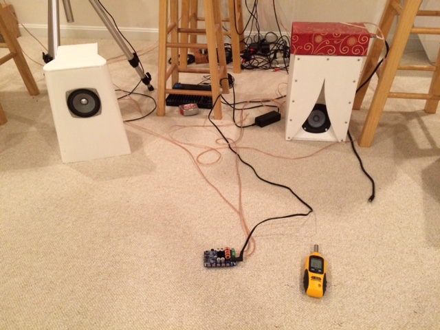

Test Sanwu 3116 BT with TL speakers
I just switched to a set of TL speakers (a FF105Wk in a labyrinth TL on left and a CHN-70 in a Karlsonator ML-TQWT TL on right) capable of nice full bass. I listened to some tracks with some good bass lines that I am very familiar with (Norah Jones - You've Ruined Me; Bob Marley - Waiting in Vain; Natalie Merchant - Carnival; Buddy Guy - Ain't No Sunshine). I listened to both the Sanwu 3118 PBTL (Xmas amp in red box above the Karlsonator) and the new Sanwu 3116 BT. I can't really detect a difference - both have great sound quality and full, rich, bass. I am surprised at the clarity and sound quality of the wireless BT. It is very nice not to be tied down with wires and still have great SQ. Based on the Sanwu boards that I have tested so far, I have to say that I am rather impressed with how good they sound, and the quality of construction/craftsmanship. Sanwu is the one to beat for SQ and overall value. Nothing else in the market currently can touch the 3116 BT for value and good sound at this point. I am going to buy several more to have on hand as these make great gifts when combined with a DIY speaker. Everyone likes a BT speaker, and they will like it even more when it's a custom designed speaker that sounds better than something available for $500 from a store.

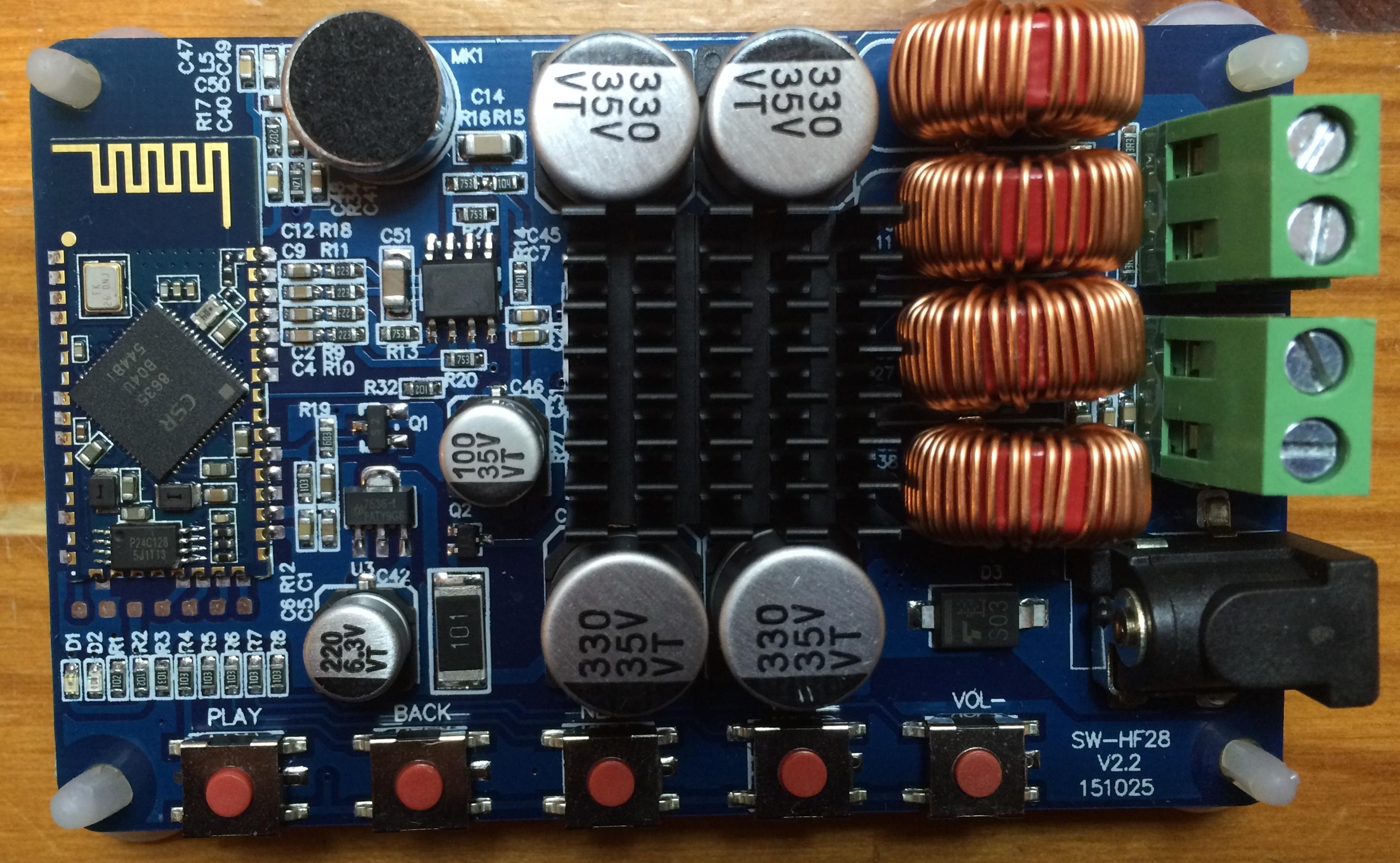

What do you mean by dump the firmware? Sure, I can get high res photos later tonight.
Nice, dumping the FW would mean to get the PSKeys from the BT module via SPI. (You may skip this task. 😀 )
You mean the FW on the BT is re-programmable? Like the beeping sounds it makes vs some that talk to tell you you are connected? I have non idea how to do that. Is it hard to do?
The FW on this unit seems to work well enough - connects easily and all buttons work as they should. Truly a marvel of low cost but high quality engineering.
Yes it is, if its a CSR (8630/35/45), there even is a DSP core included to have some limited EQ and compressor/limiter.
You need to find the SPI pins and the PCM/SPI GPIO to switch to SPI mode. Programming can be done with a chinese CSR USB-SPI and the software from CSR.
Im really interested in high quality pictures of the AFE stage between the BT module and the amp-ic.
Here you go...
(backside has nothing so low res) the 8 pin IC without designation is an NE5552 (some sort of smudge on the chip had to be wiped off to read).
For CSR SPI programming, I guess you are talking about one of these units?
http://www.goodluckbuy.com/csr-blue...luetooth-module-chip-programmer-debugger.html
http://www.aliexpress.com/item/Blue...I-programmer-burner-emulator/32224766827.html
Thanks, i suspect the bottom right 4 pins to be the SPI lines.
The programmers are the right ones, but can be sourced way cheaper.
http://www.aliexpress.com/item/CSR-...SPI-send-production-software/32246608335.html
You just have to make sure, it's 1V8 compatible.

I have the same board since december and it is a disappointment in several aspects:Nothing else in the market currently can touch the 3116 BT for value and good sound at this point.
1) poor connectivity
2) hiss
3) unresponsive buttons
4) loud beeps when pairing and pushing buttons
5) no sound until a button is pressed
maybe you were lucky to receive a "first run" board
My board is a marvel of engineering - No complaints. I must be lucky then. My board says v2.2. What is yours?
It's on bottom right corner vs photo on web is in upper right corner.
"marvel of engineering" would include stringed together output terminals for improved mechanical strength. Never understood why this is so uncommon in China. The terminals shown on the picture support it.
Also, the toroidal inductors should be RTV/glued down to stabilize them - otherwise can break off in transport. The output blocks don't bother me - as stringed together may be confusing to the user unless labeled very clearly. I wish it had wired inputs as an option. Most BT speakers have an Aux input option.
But for $12 I cannot complain given the value and noise free operation.
AUXin can be implemented by small changes in the configuration keys. Mic/Line shares the same input/PGA/ADC. The inputs are the 4 pins right below the differential out on the top right.
My board is v2.0 and what appears to be the manufacturing date: 150805My board is a marvel of engineering - No complaints. I must be lucky then. My board says v2.2. What is yours?
Can you graphically show that in photo?
Like so:
This is how it works on the CSR8645, but the CSR8635 is similar in this point. To make this work, some configuration keys must be changed.
(Gain Setting, Line-In-Mode & Routing priority)
Fixing the hiss when not streaming audio can be fixed with disabling the low-power-mode for the audio stage.
So to make this finally work you'll need one of those CSR programmers.
Regards.
Regards.
