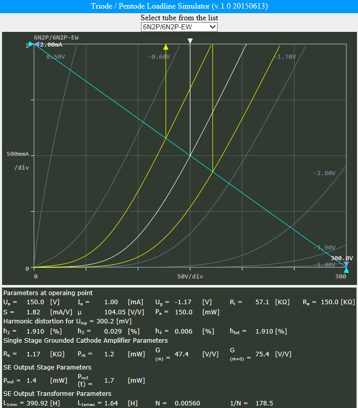

Lets stay there then. Any comments on what's simulated ?
I think you biased it too much to the left, which means it will distort unevenly, and produce harmonics with very small input signals. Make it "colder"? (Less mA)
Ok, lets try it like this then 🙂 Better, I hope 😎
Edit: It's all H2 distortion but that should work well for the "Unbalancer" since it's a differtial input, yes ?

gsmok - I think it has been asked quite a few times before, but wouldn't it be easier if the app allows the user to enter the Koren tube parameters, so you don't have to fill repeated requests to add more tube types to the calculator?
But such extended version of the program already exists I wrote about it:
Tube Loadline Simulator v.1.0 (20140909 [url]www.trioda.com)[/url]
Moreover it allows to calculate Korens' model parameters using the measurement results of a specific tube.
Sorry about that, I must have missed it. Thanks for the great program again.But such extended version of the program already exists I wrote about it:

Hi gsmok!
Thanks again for your helpful work!
Isn't the triode section of the ECL86 similar to the ECC83?
Maybe you found some time to ad the EF80 in triode connection.
I have posted the curves a few posts before.
Kind regards, Frank
Kind regards, Frank
Thanks for your remarks 🙂
Yes, you are right, and tube parameters of the models fo ECC83 and E(C)L86 are similar (see the S and mu values). There is big difference of allowed maximum power dissipated by anodes. According do data I've found the Wa for each section of ECC83 is 1W and Wa for the triode section of ECL86 is only 0.5W. So, you can see the different Wa curves when you select ECC83 and ECL86 from the list.
I'll add the EF80 as soon as possible.
