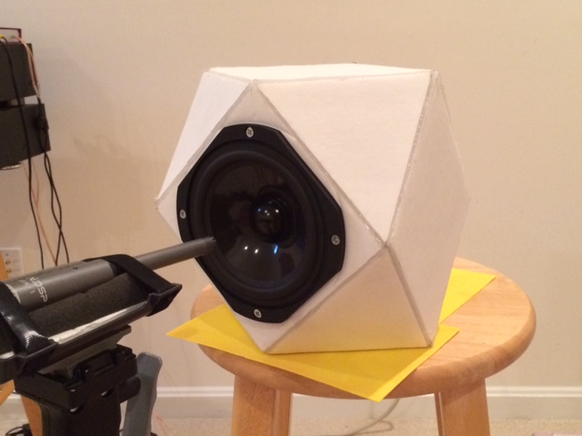

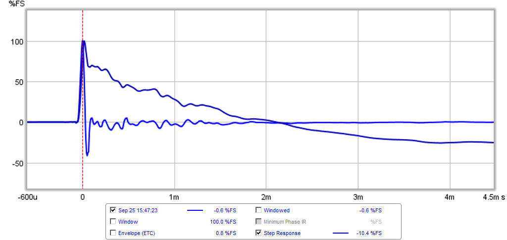

I just got an Aurum Cantus AC130F1, a 5.25in mid bass driver. The published specs are amazing and the measurement confirms this is one of the flattest, smoothest response drivers out there. It can almost qualify as a full range. I have it mounted to a sealed Hypercube with some stuffing and playing music direct drive - it sounds very nice. This cone essentially has no breakup. The Hypercube enclosure has a resonance at 1.55kHz which shows up as a small 2.4dB blip. But near field (2in meas) shows it is flat from 100Hz to 10kHz. The impulse and step response are very impressive for a woofer. Anyhow, this will be my next driver to try to integrate with a nice tweeter.
