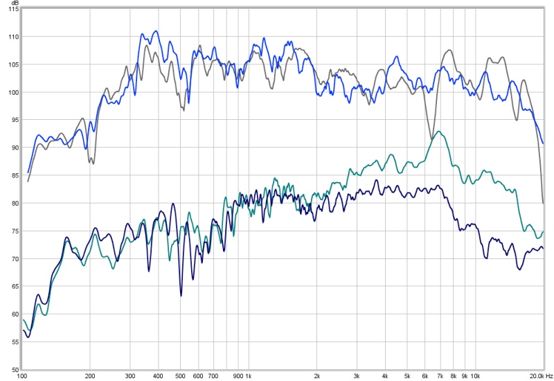

IMO, this driver works a lot better in a horn than as a direct radiator. The image is FR plots of:
Top - in a short conical horn, with roundover to a flat baffle (no driver chamber / open backed).
The horn on-axis plot is the one with the big dip at 6.5kHz, peak at 7.5kHz. These anomalies only occur right on axis.*
Bottom - on an open baffle.
The OB on-axis plot is the one with the big peak. This peak stays strong 10 and 20 degrees off axis, but is gone by 30 degrees.
My graphs are on-axis & ~30 off axis, recorded ground plane (specifically: on carpet in a moderately big room) at 1m, smoothed to 24 thingamies per octave.
I note that my OB plot is similar to that shown in this other thread (my mic distance is greater, so probably more realistic for overall balance, but contains more room effects):
http://www.diyaudio.com/forums/multi-way/248666-fostex-ff105wk-experiments.html
...so it appears that:
a) I'm not making any huge mistakes with the measuring.
b) Whether in OB or a normal (small) box, the low end falls off sharply at 150Hz.
As a direct radiator, the driver needs LF boost: +5dB <1000Hz
...after the boost is applied, the best eq is to listen to the driver about 30-40 degrees off-axis. Once these conditions are met, you'd have a driver that covers 150Hz-8kHz.
As a horn driver, it needs LF cut: -5dB <2kHz.
...then listen anywhere off axis, you'd have a driver that covers 300Hz-15kHz, and is 10dB more efficient in the bottom (more demanding) part of its range.

Nice result, I assume that the top two curves are the horn, and it seems to take care of the annoying 7.5kHz peak.
Glad you can show it works well full range out to 15kHz. A lot of people have told me full range horns will have a falloff cliff at about 4khz, and that doesn't appear to be the case here. I had similar experience with both TC9FD and 3FE22 having a nice response out to 18kHz.
Can you give more details on horn dims?
A photo would be great.
Yes, xrk971: those top 2 curves are the horn. Here is a photo of my test rig. I'm working (slowly) on the 'final' version: horn and two 30cm woofers in one box (picture of that also attached).
I just took some more measurements of the test horn.
Attached: ground plane, 50cm, with some pillows etc. placed to reduce reflections. It is thus a lazy man's anaechoic plot, and gives a much cleaner graph, but has killed off the treble. Maybe it is anomalies related to mic positioning and so on that has given rise to claims of "falloff cliff at about 4khz" ...perhaps, for horns, an in-room measurement gives a messier plot but a better indication of bandwidth.
Purple / top: the same OB plot as before (1m on axis measurement), as a baseline / reference.
Red & blue / bottom: on axis and about 20 degrees off axis. No smoothing at all - amazing how tidy a plot gets when you take the room out 🙂
Black / centre: the 20 degree graph, snapped in half with -5dB adjustment on the <2kHz section. This is all the eq I have been using; the remaining anomalies seem smaller than the effect of room reflections, or changes in mic / listening position.
So I guess this is a bit like a mini VOTT. Nice experiment. I wish more people would try Fostex FR in front horns. They really can be amazing. The old FF125K was outstanding, and the FE108EZ likes front horns too. A long time ago I ran a mono system using an FE164 over an Altex 414 with an RS pod (oem FT17) supertweeter that sounded almost too good to be true.
I suggest you try it as a quasi FAST with a good big woofer (series crossover ~300hz) and a horn supertweeter with a 1uF high pass cap. I think you will dig it.

No horn: 5dB boost required below 800Hz.
In horn: 5dB cut required below 2kHz.
Having a full range driver produce 10dB more output from the same power / excursion is a big deal.
The difference is not driver specific; I get (broadly) the same results from different drivers. I'm about to post some more graphs, which should be illustrative. The horn doesn't change the driver's basic character either - for example, the Fostex has a mild 2kHz dip open baffle, which can still be seen in the response when horn loaded.

-I'm not as rigorous as some, so my "on axis" might be 1 degree off for graph A and 3 degrees off for graph B
-no gating, no special shenanigans, so this has room artifacts.
These graphs are from REW*, an average of four measurements: on-axis, 10, 20 30 degrees off axis. The Fostex is the paler trace in both, and has the 2kHz dip in both.
The Fostex prefers the round horn, and the P-Audio seems happy either way. Doesn't seem to have been worth the effort!
*REW averaging seems to weigh peaks heavily - that is, a peak that is only present on 1 graph shows much more clearly than a dip which is only present on 1 graph.
I used two drivers, the Fostex from the title, and a similar P-Audio unit. The cone:throat is almost 1:1 (no compression).
Caveats:
-the oval horn is obviously slightly larger, meaning a little more depth to get to the same throat size. The round horn was smaller, but on a baffle. I don't think the <500Hz part is comparable.
-the P-Audio driver is a few mm larger.
This is a more detailed comparison of the drivers on the round horn. In each graph, the Fostex is the paler trace. The drivers are more alike than different.
The P-Audio is more ragged on axis (4-10kHz), but it flattens out more rapidly as the mic position moves off axis.
Either driver is best off axis, with simple shelving to reduce the output below ~2kHz.
