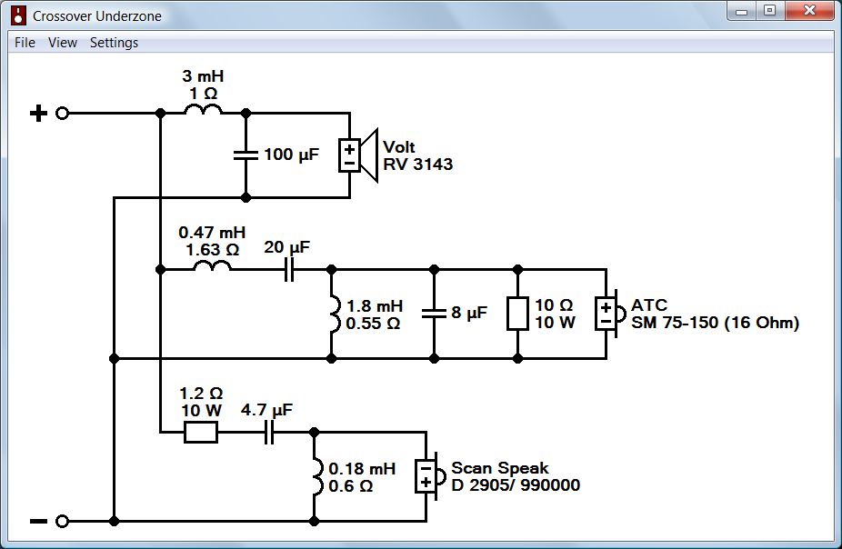

Any more POSITIVE suggestions about how to improve my crossover please?
Get measuring equipment, measure the drivers and put the measured data in the crossover simulator. Simple as that. Everything else ("generic crossover", using other drivers data in the simulator, etc) is just plain wrong.

Dissi, what values of L1 and C1 to reduce the SPL hump would you recommend please?
The original filter has a coil made of thin wire with a resistance of perhaps 1.6 ohm (guess) and a 1.5 ohm resistor in series to the shunt capacitor. Both resistors do help to damp the resonance. Attached is a zip file containing a generated impedance data file (RV3143.zma). Import it in Boxsim and then your simulation will show the hump also. 🙂

Good modelling contribution from Dissi there. I followed that. It's not rocket science that a high inductance 12" paper VOLT RV3143 woofer needs some shunt resistive damping to avoid a peak in response. It actually looks like it has natural rolloff around 700Hz, which is useful. And upping mid level also looks good and justified.
So Jim, I think you need a 1.5R or 2.2R resistor back on the bass filter shunt. 100uf or 120uF is neither here nor there. Not much difference IMO, unless someone wants to argue about it! 🙄

I had a look at KatieandDad's rough measurements on the original troublesome filter which led to my ideas on a fix.
Below is the K&D measurements and mine and Dissi's sims, and bear in mind K&D's comments of a midrange that lacks energy and sparkle.
You are quite close to where you want to be now, IMO. Fix that bass shunt. I notice you've upped the 6.8uF to 8uF which is heading in the right direction too. Losing the 4.7R on the mid input altogether is perhaps a bit too dramatic IMO, I would have tried 2.2R myself,especially to keep impedance up. But it's your project.

I did my usual "BS" rough and ready stuff with Dissi's ZMA here. It's just upping Le inductance really. I can do that in my head. 😛
IMO, with only 3 variables to play with on the bass filter, 3mH, 100uF and a resistance anywhere between 1.5R and 2.7R just does the usual tradeoffs. There isn't a perfect answer. 4mH doesn't look any better. A higher order filter is indicated. We're not gonna do that.

After creating .zma files for my drivers amplitude and impedance response using SplTrace I think I have finished the crossover. I have massaged the crossover to reduce the hump that comes from the top end of the Volt 12" bass driver and the overall response seems OK.
