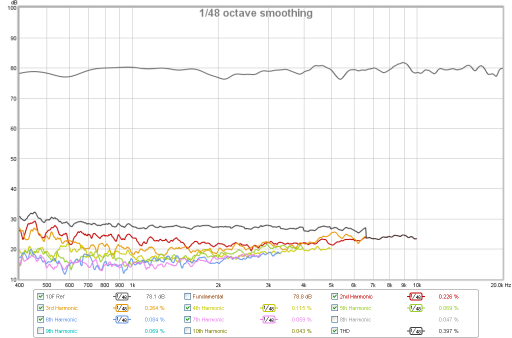

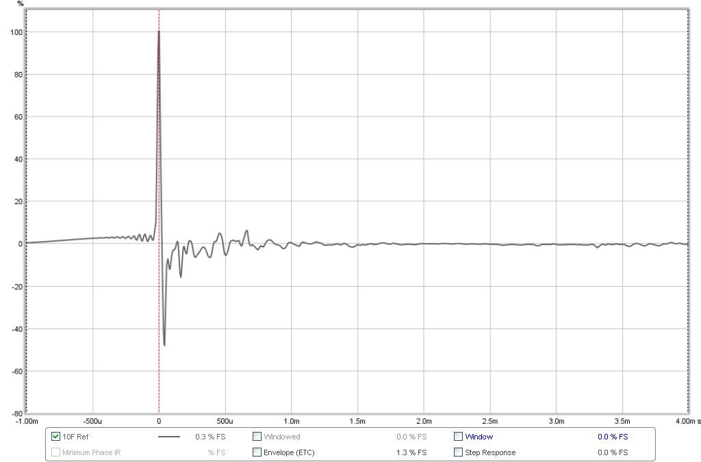

Just so you can see what the 10F/8424 looks like when measured in the 10F Ref Monitor which uses a triangular pyramidal "Dagger" backside enclosure for 10F, here are the corresponding IR and HD plots.
Impulse Response:
498314d1439456675-subjective-blind-comparison-2in-4in-drivers-round-3-round3-10f-ref-ir.png
Harmonic Distortion:

I think I don't believe the THD charts, I mean, all drivers look similar here. In reality, small difference can make or break.
HD plots as I said, were measured at a very low 1.4 volt drive level - which will mean drivers are hardly stressed. For real comparisons, a higher level of stress, typically equivalent to 90dB at 1m will be required for the good drivers to really shine and the mediocre drivers to fall apart on the HD front.
I just did not have time to measure the HD at high drive levels.
I'm actually rather impressed by the performance of the FRS5X (A), though the THD is marginally higher across the band than the others, there are no real peaks to speak of (like C & D) or a rising THD like E, despite their overall level being lower. Absence of THD peaks at the LF end of their usable range is a bonus for the FRS5X and the others (excluding C&D, and maybe E).
Do you mean it's measured performance? I don't understand why you like this driver. I have a pair and I don't even want to waste my time using them.
I see. That explained it, then...

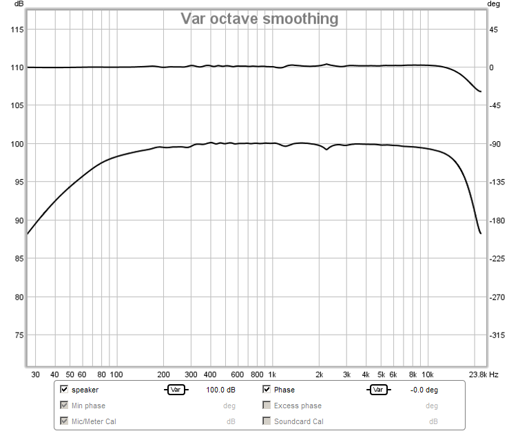

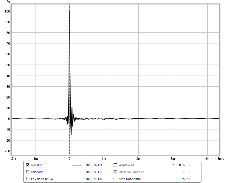

The Frequency Response (FR) and Impulse Response (IR) are actually inextricably linked via the Fourier transform. In many measurement systems, the native or raw data is the IR (time domain) and performing a fast Fourier transform (FFT) on the IR gets the FR. Some systems measure the FR and use the inverse FFT to get the IR. Once you are familiar with the transforms, you will see that any ripple or glitch in the FR has to show up as some sort of additional time component in the IR. A larger peak in the FR automatically causes a "ringing" in the IR. A perfectly flat FR produces a perfect single pulse IR with little pre- and post- peak small amplitude ringing that looks like a Bessel function.
For example, here is a perfect frequency response from a speaker that Barleywater made using the TC9FD and a woofer in a FAST and some digital signal processing:
Here is the corresponding IR for a perfectly flat FR:
Pretty impressive what one can do with a FAST and some DSP magic...

xrk971 10F/8424 measurement from post 242 http://www.diyaudio.com/forums/full...2in-4in-drivers-round-3-a-25.html#post4419076.
498315d1439456675-subjective-blind-comparison-2in-4in-drivers-round-3-round3-10f-ref-hd.png

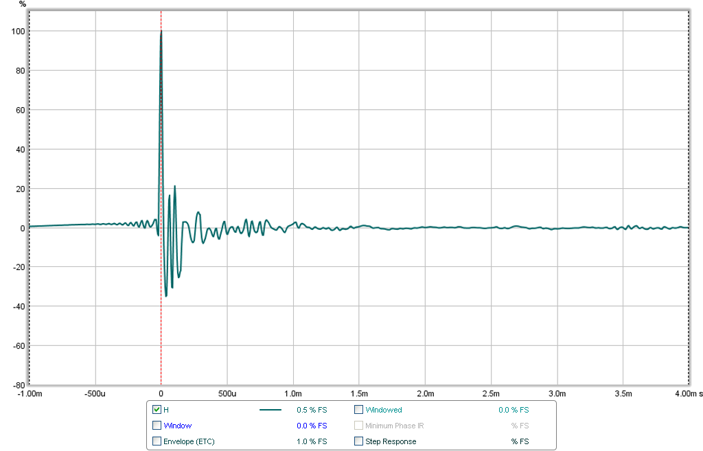

498299d1439432985-subjective-blind-comparison-2in-4in-drivers-round-3-round3-driver-h-hd.png
498289d1439432788-subjective-blind-comparison-2in-4in-drivers-round-3-round3-driver-h-ir.png
