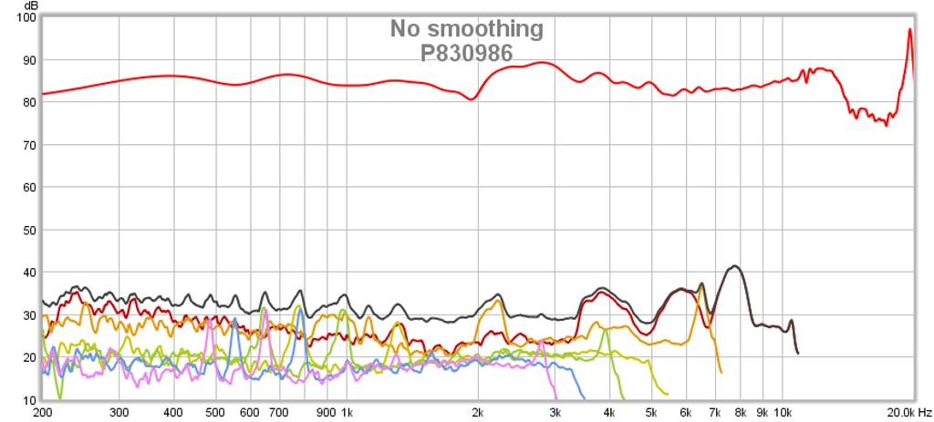

I don't know anything about RESA, but your step response measurement of the Peerless shows that they probably did that on purpose.
2. The 20 Khz "zinger" on the P830986 - what about folks who don't have hearing that doesn't go that far? There's a null area below the HF bump. If people with hearing topping out ~16 Khz still perceive "air" on this driver, which part of the FR spectrum is likely to be the source?

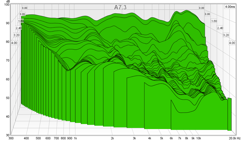

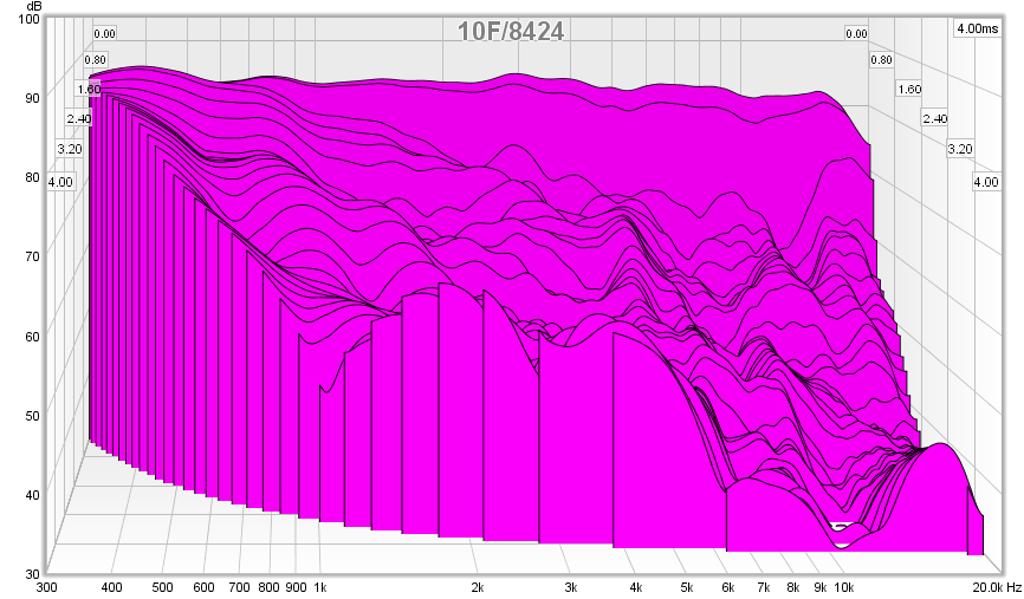

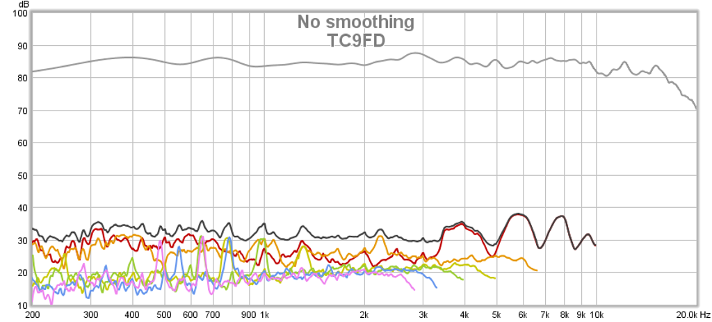

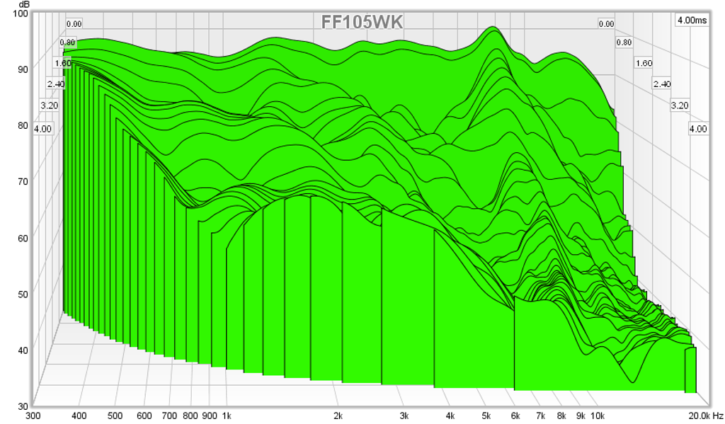

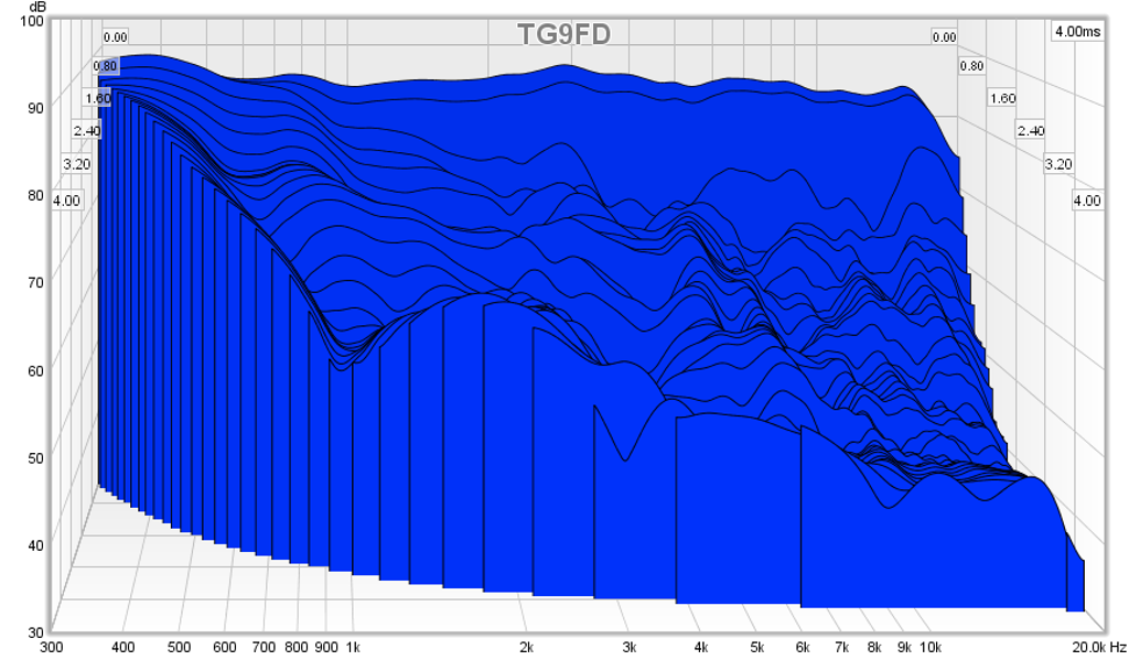

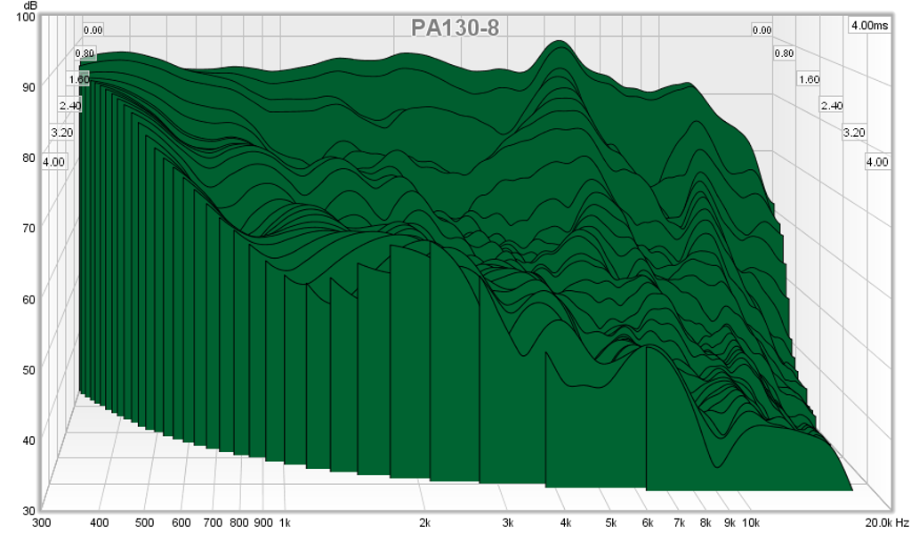

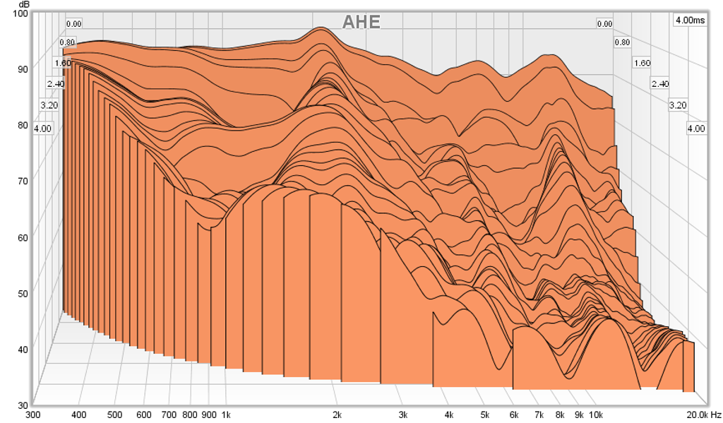

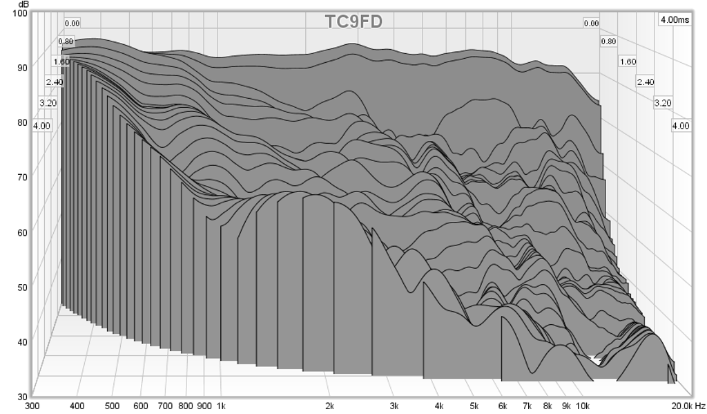

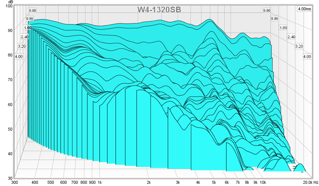

Most CSD's I've seen use more smoothing and a scale out to -30 dB below the signal.
Maybe try that? At least with previous plots you're being brutally honest, but it makes theme harder to read. The spectrograms seem more smoothed by themselves in comparison. We have to remember that this is a speaker in an enclosure, same enclose for all speakers but still might be of influence to the plots.
CSD with 1/6th oct smoothing
Wesayso,
Ok, I agree that the 1/48th was tough on the eyes. Here is 1/6th octave and I reduced the range to 4ms, window is still 3.7ms, 41 steps, and more vertical range.
TC9FD:
P830986:

W4-1320SB:
483879d1432035221-subjective-blind-comparison-3in-5in-drivers-round-2-w4-1320sb-csd.png
FF105WK:
483880d1432035221-subjective-blind-comparison-3in-5in-drivers-round-2-ff105wk-csd.png
TG9FD:
10F/8424:
483882d1432035221-subjective-blind-comparison-3in-5in-drivers-round-2-10f-8424-csd.png
AHE:
A7.3:

Wow, look at the 20kHz zinger on the P830986, it keeps going and going like a knife ridge on a mountain. At first, I thought the CSD of the TC9FD looked better than the more expensive 10F/8424, but on closer inspection, the critical HF region does appear to decay a bit faster on the 10F. If you look at high high the "cliff" on the front where the data cuts off due to the window size, you can get a sense of which driver still has some energy left to dissipate and where that lies.
I think these CSD plot settings are much more useful for viewing and making some interpretations.

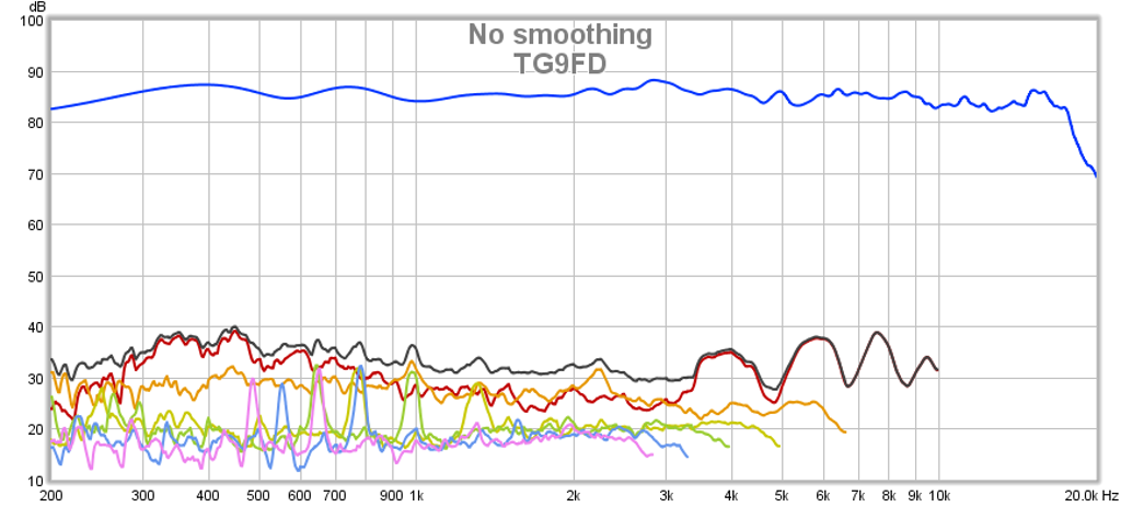

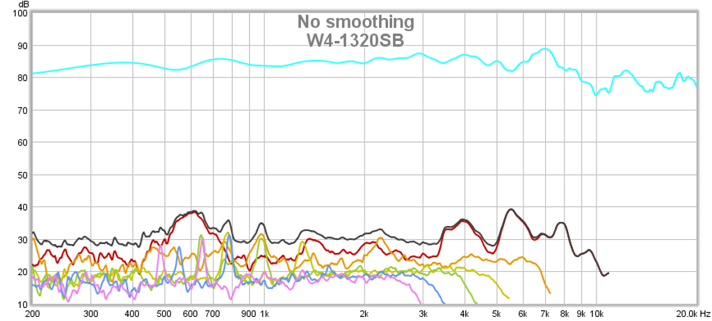

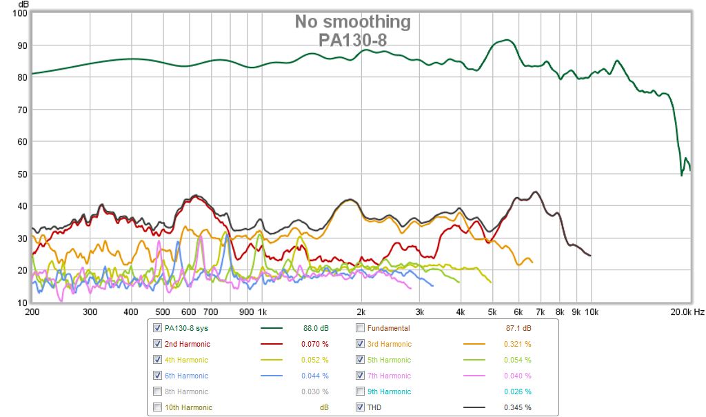

Harmonic Distortion of All Drivers
Here is the harmonic distortion up to 7th harmonic.
