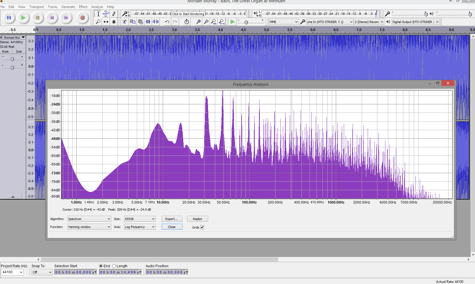

This is the image that was posted before, a 10 second frequency/amplitude analysis of a pipe organ. Clearly the 16 hz note has a LOT wider bandwidth than 16.0 to 16.0 hz. It looks like it extends down to 14 hz at the 10 db down point. Even at 3 db down it's 2 or 3 hz wide, extending below and above 16 hz.
Again, not that this matters much, but a hpf is required, and I showed you a proper hpf and what happens when you apply it.
The 8hz fundamental is interesting, but what do you know.... the 32hz harmonic is almost 20DB!!!! hotter than the 16hz fundamental....

What program did you use for your analysis?
Looks interesting.
I did that a few pages back with Audacity.
FFT analysis of a dynamically changing signal, like music, gives just rough estimate. Theoretically it is invalid.

On the bandwidth issue, I think it's important to note that the pipes, the wind that drives them, and all the environmental factors probably do add up to low notes that don't perfectly track a single fundamental frequency, but rather wag around a little bit, especially if they're played with vibrato.
We can't live in the theory world when we're talking about a physical instrument that most likely refuses to comply at every available opportunity.
