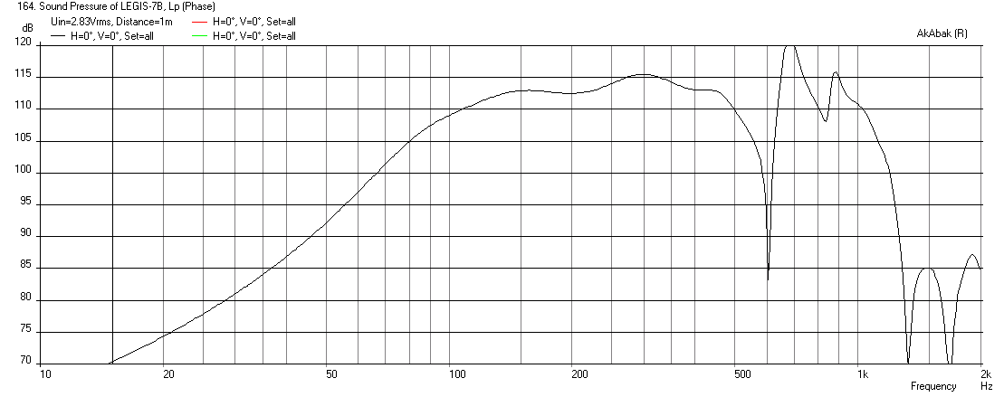

I finally measured the sensitivity (indoors) of the two synergy bands. Drive voltage was only approx. 1.45V in both cases. Meas. distance 1m from the mouth. Averaging 1/48oct. Both the Deltalites and 2446J were without XO and EQ.
To get 2.83V sensitivity, one must add 5,8dB to the results (this equals 2 watts for the Deltalites, 0.5 watts for the 2446J). To get 1 watt (4V) sensitivity of the 2446J (16 ohm) one must add ~8,8dB to the result.
The 2446J is most efficient at the same band around 700 - 1.5kHz where this size conical horn is also "waistbanding" (= directivity index rises to 17-18dB compared to regular 14-15dB elsewhere), which explains the monstrously high 4V/1w sensitivity readings around these freqs.
The ribbed titanium dome has HF resonances that generate respectable H2 spikes in the distortion plot. But H2 at those freqs does not sound offesive, perhaps adds sparkle. Below 500Hz all distortion components rise quickly, JBL "diamond pattern" metal surrounds' feature perhaps.
2446J: 600Hz/110dB/1,5m/~0,25% H2. The condenser mic itself distors at the levels, the reading are not super accurate.

I think the sims predicted 110dB sensitivity at 2.83v on the Deltalites. Very impressive system with low distortion and able to be driven with a flea amp for normal listening.
By the way X, I have also driven the PP tapped horns with Tripath TA2024. I cannot get it to clip with bass heavy music even when my Radioshack reads 110dB (C-weighting, fast, max) at listening position 🙂. It's ridiculous how a tiny TA2024 drives them. Maybe I someday just crank until TA2024 clips to find out the limit. I measured output of 107dB/1m/2.83V/50Hz from one of them playing in room.
The sensitivity of Deltalites was predicted somewhat higher than 110dB, around 112-115dB in the most sensitive band: http://www.diyaudio.com/forums/subwoofers/258706-study-dipole-cardioid-bass-horn-21.html#post4013664

Legis,To get 2.83V sensitivity, one must add 5,8dB to the results (this equals 2 watts for the Deltalites, 0.5 watts for the 2446J). To get 1 watt (4V) sensitivity of the 2446J (16 ohm) one must add ~8,8dB to the result.
Great to see your test results!
The 2446J's rapidly rising low frequency distortion is simply the result of diaphragm excursion from the shallow second order electrical crossover coupled with a horn without much low frequency loading, actually a bit surprised to see that much distortion at only about .12 watt input.
The "respectable" distortion amounts of 12.6% at 5kHz, 44.7% at 7 kHz, and 39.8% at 10kHz are the part of the signature sound of the JBL ribbed titanium diamond surround diaphragm.
That said, the level of distortion you measured seems higher than I recall from using the 2445, which did not have ribs, but shared the diamond surround JBL used on all their HF drivers (other than the ring radiators) of that era.
Your driver is exhibiting distortion an order of magnitude higher at almost an order of magnitude lower drive level than the 2445 published distortion levels (can't seem to find any 2446 distortion specs with a quick search). Are you sure the diaphragm(s) are properly aligned? A lot of people are under the impression that the diaphragm alignment dowels insure alignment, but they don't, and a slightly dragging voice coil former (or coils) generates a lot of distortion, clearly audible as buzzing when doing a low frequency sine wave sweep around 200-500 Hz at around 1 volt. At these low frequencies, the driver has little output (if off the horn) so the distortion caused by dragging is not masked by the output level. Since the dragging may only occur at certain frequencies, it may not show up with music, especially at the low drive levels you are using.
If you do hear buzzing, loosen up the diaphragm screws so they are barely making contact, and while the sine wave is playing centered on the frequency that generates the buzzing, tap on an edge of the screw rim. In one direction, the buzzing will get worse, tap in the right direction and it will go away. Once you get it buzz free, repeat the sweep to make sure it does not buzz at another frequency, when you have got it aligned, tighten the screws, and sweep again.
Even properly aligned, debris in the gap can cause buzzing, before installing a diaphragm the gap must be thoroughly cleaned using masking tape run around the perimeter until no debris shows on the tape. This is another step often left out by amateur installers, who often burn up diaphragms and then replace them at the last minute before the next gig.
It is surprising how much crud can be in the gap of what looks to be a perfectly clean driver.

Art, I did not use XO in the measurements, they are completely "raw".
They do not buzz at "human drive levels" with the 2nd order HPF @ 500Hz but now when you say it like that I will have to try center the membranes better in near future because they have a buzz when playing <500Hz sines without XO semi loud. So centering can be somewhat off! I always though/assumed it's related the old diamond pattern surrounds that have "weakened" or something. Drivers are mint condition but I did not buy them new.
JBL tolerances are so damn tight, it's both a good thing and a bad thing.
I will just leave some 100-500Hz sine sweep on repeat and see if the buzzing goes away with tapping.
I will propably upgrade to Truextent Beryllium mebranes at some point, even though I like even the ribbed membranes.😀
I opened the measured driver, loosened the membrane somewhat and tapped it until it did not buzz anymore, and then tightened and measured it again. The levels are not exactly the same in both measurements but very close. 1/48ock smoothing in both. (I would not take the differences in FR for granted, since it seems to change every time I make a measurements like I do, ie. by not controlling the mic's location precisely. But some FR smoothening is possible.)
I definitely have to tap the other driver into order as well.

What band/region do you mean where the distotion should be lower specifically with 2446J?
I suspect ribbed 'phragms of 2446J cause the upper H2 spikes to be more pronounced, where as non-ribbed 2445J does not have as spiking break-up modes. Both drivers measure almost identically after I tapped them both into alignment.
I have cleaned the air gap(s) multiple times (it was hard to get right) before, so they should be clean.
Looking at your .13 watt (or whatever 1.44v into 16 ohms is) chart and comparing it again to the 2445 one and 10 watt distortion posted in #370, it appears the low and midband distortion is in line, but the HF distortion would exceed 100% at just one watt.What band/region do you mean where the distotion should be lower specifically with 2446J?
That's probably why no 2446 distortion plots come up in a google search.
You probably have got them aligned as good as possible, they just have some nasty upper breakup.
At least the alighment and cleaning helped the low end, and since you have tweeters, you can cross the 2446 out before the upper splash.
I also quess that's why no THD plots are available 🙂. The high H2 spikes look nastier than they sound, they are so high in frequency.
Beryllium phragms have the first resonance at ultrasonics (22-26khz), and they are lighter than Ti/Al. I have heard TAD 4001's which sounded very nice and clarity is superb at high SPL.
I quess why some prefer JBL 2445/2446/2450 + Truextent to TAD TD4001, is the reason (partly) that JBL has aluminum phasing plug and TD4001 has plastic. TAD did not use aluminum phasing plug until TD4003 which is said to be the best sounding 2" TAD. Other aspects in ther drivers are almost flawless by any standards. As are in JBLs, but in reveresed order - flawless, all-aluminum construction and superb tolerances, but compromised diaphragm material (in their older drivers, some newer have Be 'phragms).
