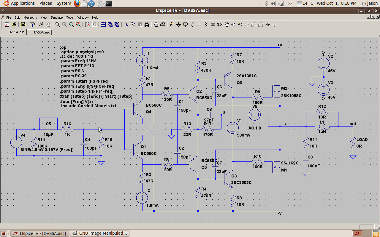

Esperado put forth a VSSA variant that was DC coupled (intended to make use of a DC servo) by using a diamond buffer input. I know some don't like the diamond buffer due to some concerns about stability but in this example it seems to work out pretty well. I couldn't get the distortion to simulate as low as Esperado but I'm intrigued by the possibility of DC coupling, especially eliminating the split NFB paths and big DC blocking capacitors.
I started just playing around with it and found I could get some pretty good PM and GM with some (rather large values of) lead compensation. I need to bring into to simulation realistic CCSs and bias spreader to make it a more complete circuit, but this give a little hint of what it might be like.
Thoughts?

Yes, I just wanted to see basic performance, offset notwithstanding. A real build may or may not need a DC servo, but of course a servo makes offset a non-issue. For the basic simulation the servo was an unnecessary complication.
R1, R2 - R in series with respective current source isolates the active devices from C in the current sources. Right?
Usually, these resistors are in series with the emitter of Q1, Q4.
Their purpose is to provide a bias for Q2, Q5 and to set the quiescent current of these transistors which receive the negative feedback on their emitter.
Even if R1, R2 were in the right position, I am not sure of a stable DC behavior of the circuit.
I just drew the circuit as presented by Esperado, minus the DC servo which in real life would almost certainly be included, and with lead comp (C8) added. LC said C8 was dangerous, and it might be, but in the simple simulation it gained me more PM and didn't compromise GM.

Hi forr,
I meant R1, R2 in series with the CCS intrinsic capacitance. These resistors will not alter standing currents.
But, these resistors will dampen the Q. I think John Curl wrote somewhere "making the CCS less hot".
R1, R2 will drop 75 mV, in series with several M Ohms of CCS impedance will do exactly nothing.

Would agree with LC on this one. Having messed around with various CFA prototypes, have found that too large a value in position C8 can cause instability / oscillation. Putting a resistor in series with C8 may help keep things stable.
Gain and PM "peaking" right at the UG point. I don't use this for my CFA's , but on my hawksford/leach ... I use 100R/5p. Being a VFA (only need 5P) , this allows for more PM @ higher UG's (as JK observed).
PS - the observed "peaking" made a high slew SW "ring" 🙁 .
OS
