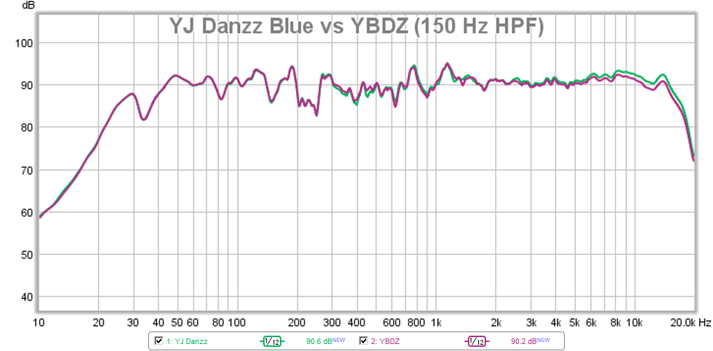

When I first got the YJ blue/black I compared it with my Ybdz with listening and measurements using a mic in the same setup and it did feel a little brighter. Not much but you can see here in the response at listening position. This is stock on both amps.
If the brightness bothers you, a mild -1.5dB EQ (Q=0.5) high shelf from 6kHz should do the trick. Or tlt more off axis.
