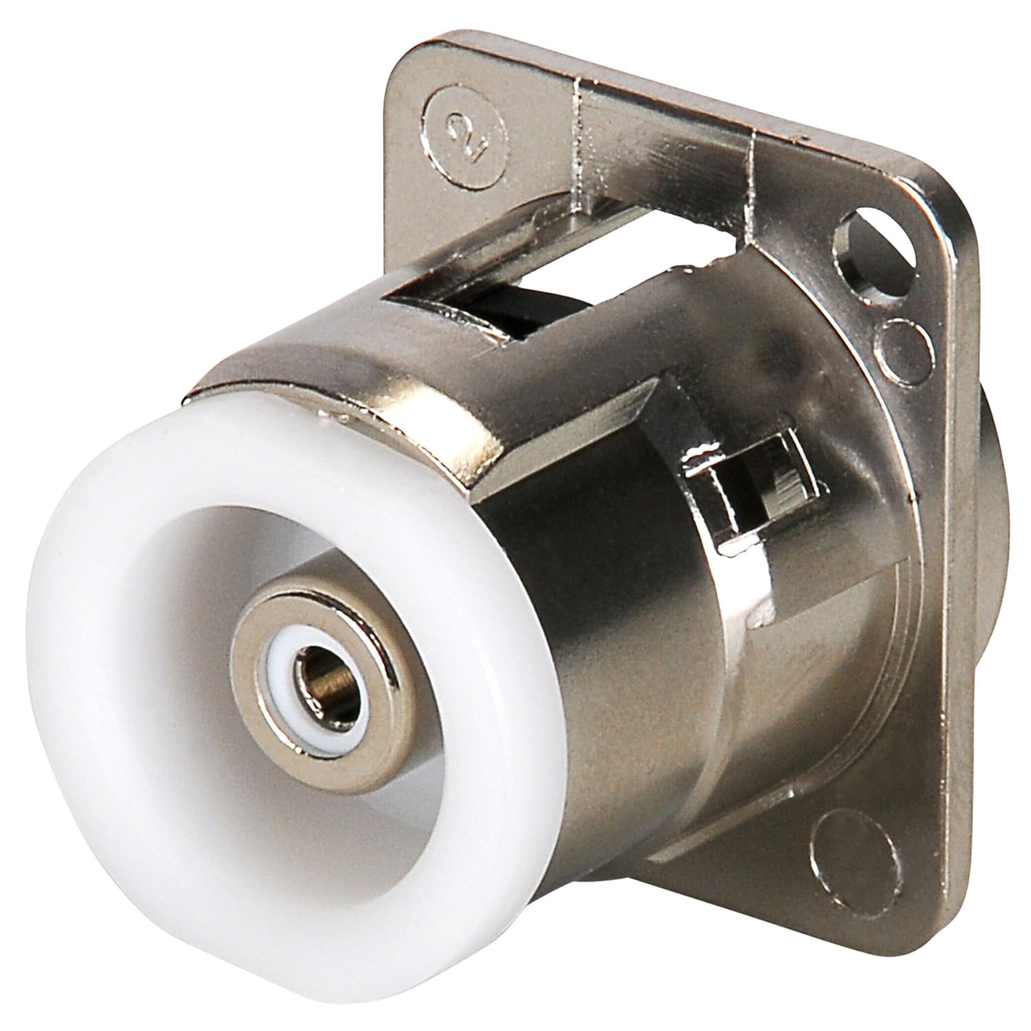

Why bother with WBT ones when you can get these for a lot less:
NF2C-B/2 - Neutrik

SMA is tiny. No reason to fiddle with something so small for audio. For microwave it makes sense, as small size delivers something useful.
NF2C-B/2 - Neutrik
Hi and thanks but ... i remember that also these are not cheap
As i said i am mostly worried by the quality of the RCA inputs on equipment
Only the very expensive ones have decent RCAs
So my best solution could be to replace the panel RCAs with something decent and absolutely with teflon insulation 🙄

You can get a Switchcraft 3502A for under $2.00 U.S.
Hi and thank you very much indeed for the suggestion of this brand.
