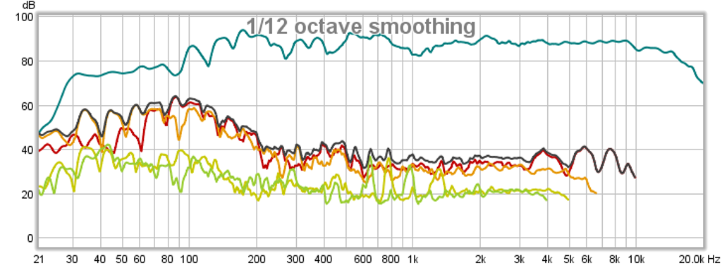

Regarding distortion at low frequencies - yes it starts to climb from -50 dB when you go lower than 200 Hz. I have accidentally achieved audible bass levels (75 dB) down to 30 Hz! Perhaps room gain going on but nonetheless - measurable. This was in a wall mounted flat "Accidental MLTL" which actually sounds quite nice as a background music speaker. I am still scratching my head over this one - the HD was large but no greater than -10dB at the worst, and typically better than -12 to -15dB below 200 Hz.
Here is the HD measurement at 1 m away with speaker mounted 53 in above floor (driver axis):

I don't think there is anything really inconsistent between my measurements and the factory measurements. It may be due to the presentation scale that I used. The -10dB to +110dB scale as used by MA has a nice way showing a driver in the best light. Here is the same data presented on the 50dB to 100dB scale used by Tymphany. Now with warts exposed, you can see that the 60 deg data is about the same in both measurements.

Pass re the details of the HD levels; could be any one of a number of factors, so we'd need to be taking it back to the raw anechoic measures on an IEC standard test baffle, preferably in an anechoic chamber to have a baseline. Interesting though. As indicated it's higher than I like, but that's somewhat of a moot point since this is where personal preferences / criteria etc. all start to kick in & no doubt still very useful in nearfield etc., since we're not really talking 'ideal world' situations. Or we'd all be running our dream systems.
