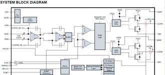

The 3116 has a balanced input that works with the differential output (a good way to get more voltage swing out of a single supply) and a balanced architecture so it can cancel common-mode EMI, RFI etc...
The +/- caps should be the same so the inputs 'see' the same thing and stay in good ... balance.
Many amps also have balanced inputs because many DACs have a differential signal (easy way to get 2Vrms output out of a 5Vdc supply)
The input works best when both inputs are very similar. Looking back from the + input and through the volume pot, when the pot is at full or zero it looks like gnd. That's balanced with the - input because it's connected to gnd.
But when the pot's in-between and worse case is at 1/2 resistance (~3 o-clock) when the positive inputs sees 1/2 of the pot going to gnd and the other 1/2 going to Vin (ac gnd). So for a 20k pot, it will see two 10k resistances in parallel or 5k. This gets added to the input impedance but only the + input.
At 26db gain, the input impedance of the 3116 is 30k. But now the - input sees 30k and the + input sees (30k + 5k =) 35k Not balanced.
So the best way to drive this amp would be from a preamp--which has low output impedance that doesn't add much to impedance seen by the + input ... and with the pot removed.
A good candidate would be a pair of TI DRV135s to drive the amp inputs thereby isolating the amplifier chip completely from the input. If placed very near the input on the board all induced CM noise that invariably will occur with a quite powerful output running through large inductor would be canceled.
