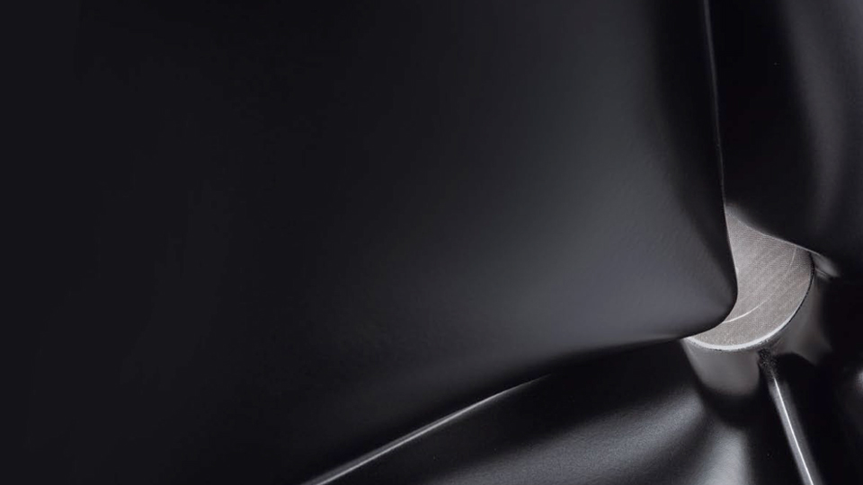

The cross sectional area continues to expand from the throat diameter, the narrow diffraction slot allows dispersion to higher frequencies.
Interesting. So it's similar to what happens in the phase plug, where the width at the throat is smaller than the width at the diaphragm. But in the M2 they achieve a smaller throat while the expansion rate is still growing, because it expands on one axis (diagonally) while shrinking on the other (vertically and horizontally)
Thats what is interesting. why do it twice.
H9800
IMHO, it's a way to have your cake and eat it too.
Let's say that you want to control polar response from 13,500hz and down. That's going to require a compression driver with a 1" throat. (13,500hz is 1" long.)
But the M2 has a 1.5" throat, and we'd 'normally' expect directivity to become uncontrolled above 9000hz. (Due to the 1.5" exit.)
So the beaks allow JBL to have their cake and eat it too. It allows a narrowing on the horizontal and the vertical axis, while still allowing the waveguide to expand on the diagonals. So the waveguide is still expanding, but the beamwidth is not... or at least it's not in the dimensions that we measure (left, right, up, down.)
