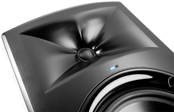

Well that trickled down fast. JBL released some new speakers two weeks ago.
$10,000 for the pair and $10,000 for the amps and processing? (I'm too lazy to google it.)
JBL LSR305, $300 per pair
JBL LSR308, $500 per pair
Amplifiers are included.

I am goig to try an Econowave style enlosure just for kicks and largely because of this thread. Puuting the big boy on the back burner. I now need some official opinions about which waveguide/horn to use.
Here are the choices. I am leaning toward the Seos or JBL clone simply because it will allow good CTC spacing. In truth, the polars of the DDS waveguide(geddes clone?) and QSC look better, but it wold seem to make crossover a bit more difficult. I am not considering Wayne's horns or Geddes kit just because I am being cheap. I figure I can get the horns and the compression drivers for same price as the wood needed to diy the wood IWata's. If I like what I hear, these will probably be passed on and I will go hole hog on the next one, if there is such a thing.
Box will be a variation of the first pic. It also show s the QSC waveguide that seems to have best response, being very close with Geddes alternative, by DDS. Woofer will be TD12s because it can go low in small box and still get high enough to cross with the HF drivers, at the cost of efficiency, of course.
