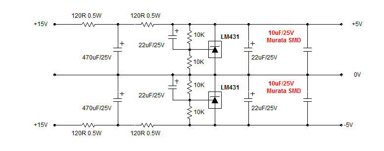

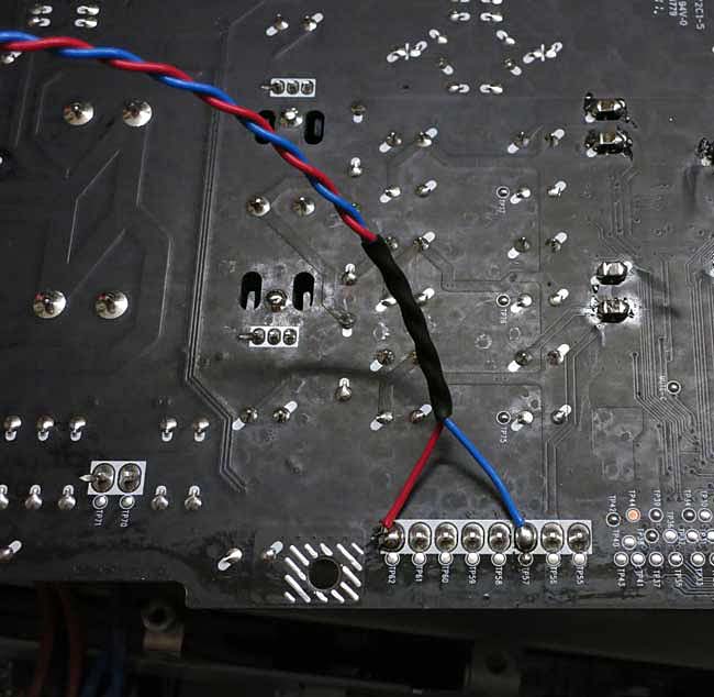

PART THREE
POWER SUPPLY TO POST-DAC CIRCUIT:
While I am using a shunt reg because the PCB I used already had them in situ, you can of course use 5V fixed regulators.
(Note: Four of the Murata caps are needed, a pair locally to each of the OPA-860.)
DC power comes from under the Stereo PCB. Please see the photo where we tap into -/+ 15V:
There is no 0V this is taken from here. I took this from near the DAC as a separate Ground wire. I like to use something that is similar to a Litz wire or multi-strand, so as to have near zero inductance in the Grounding.
Note there is no 0V - this is coming from near the DAC where an engraver was used to create a Ground Point:
The RCA Sockets needs to be floating.
Of course, Oppo can use their existing Ground Plane earthing.
COST: The cost is similar.
Next: Part Four

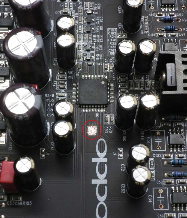

PART FOUR
SAW CLOCKING & DIVIDER:
Two clock frequencies are required and they are 54MHz for Sabre DAC (can be up to 100MHz per datasheet) and 27MHz for the "Master Clock" on the Mediatek chip. Note that they are 2:1 and that means we can use a single 54MHz SAW oscillator for direct input to Stereo DAC (and via balanced buffer drive to Multi-Channel DAC) and using a divide-by-two ship to produce the 27MHz.
Schematic:
(Note that 10R in the return for 27MHz - without it you may risk increased player freezing.)
On the Oppo's Stereo Board, only the old 54MHz oscillator must be removed and three wires from above is wired to it:
As shown, we will be using the existing +3.3V clock power supply for the Sabre DAC clock after removing the existing oscillator.
How to wire the 27MHz is shown earlier on this thread.
NXP 74HC4040N (90MHz) Farnell/Element14 Part # 380-880.
Of course, Oppo could decide to use two separate SAW clocks, but they would need a decent power supply for the 27MHz and also ask Epsom Toyocom if they can make 27MHz SAWs (the lowest they have made so far is 50MHz) and if not, use 54MHz (which still has to be custom ordered like I did, but in large quantity and using two of them per player, the cost is negligible) and 2:1 divider.
Incidentally, Oppo could be attracted by the thought that we have people who say they also see an improved picture quality when using decent clocking here, rather than a cheap 27MHz Xtal. They could also order them in a smaller form factor than 7x5mm we have.
COST: The added cost, if any, is likely to be very small and possibly nil.

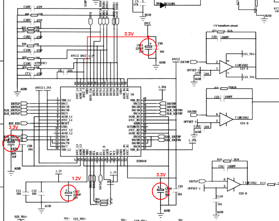

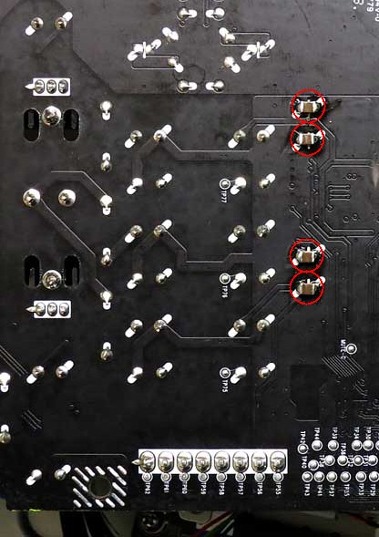

PART FIVE
MURATA SMD ON DAC ETC:
Murata 10uF/25V SMD 1206 - GRM32NF51E106ZA01L - Farnell/Element14 Part # 952-7818.
These are excellent in reducing the noise floor, not just from the power supply but also the back-EMF noise that the DAC emits. DACs are essentially switching devices, and produce switching noise - this is indeed known and the DAC's manufacturers usually recommend a 100n ceramic (which we can leave in place), but that value is woefully inadequate and 10uF is actually a minimum, and electrolytics just don't cut it, for rather obvious reasons.
Below shows the four on the DAC.
As schematics above show, we are also using them in other areas. Right close to Pin 7 and 4 on the OPA-860 in a similar way that Oppo are using 0.47uF poly caps at the moment. Also used on the clocking and on the DAC power supply pins in same situ where Oppo are currently using electrolytics.
In total, ten will be needed. Four for two OPA-860s, four for DAC and two for the clock circuit.
COST: Not much different from equivalent electrolytic caps.
Next: Part Six - Conclusion.

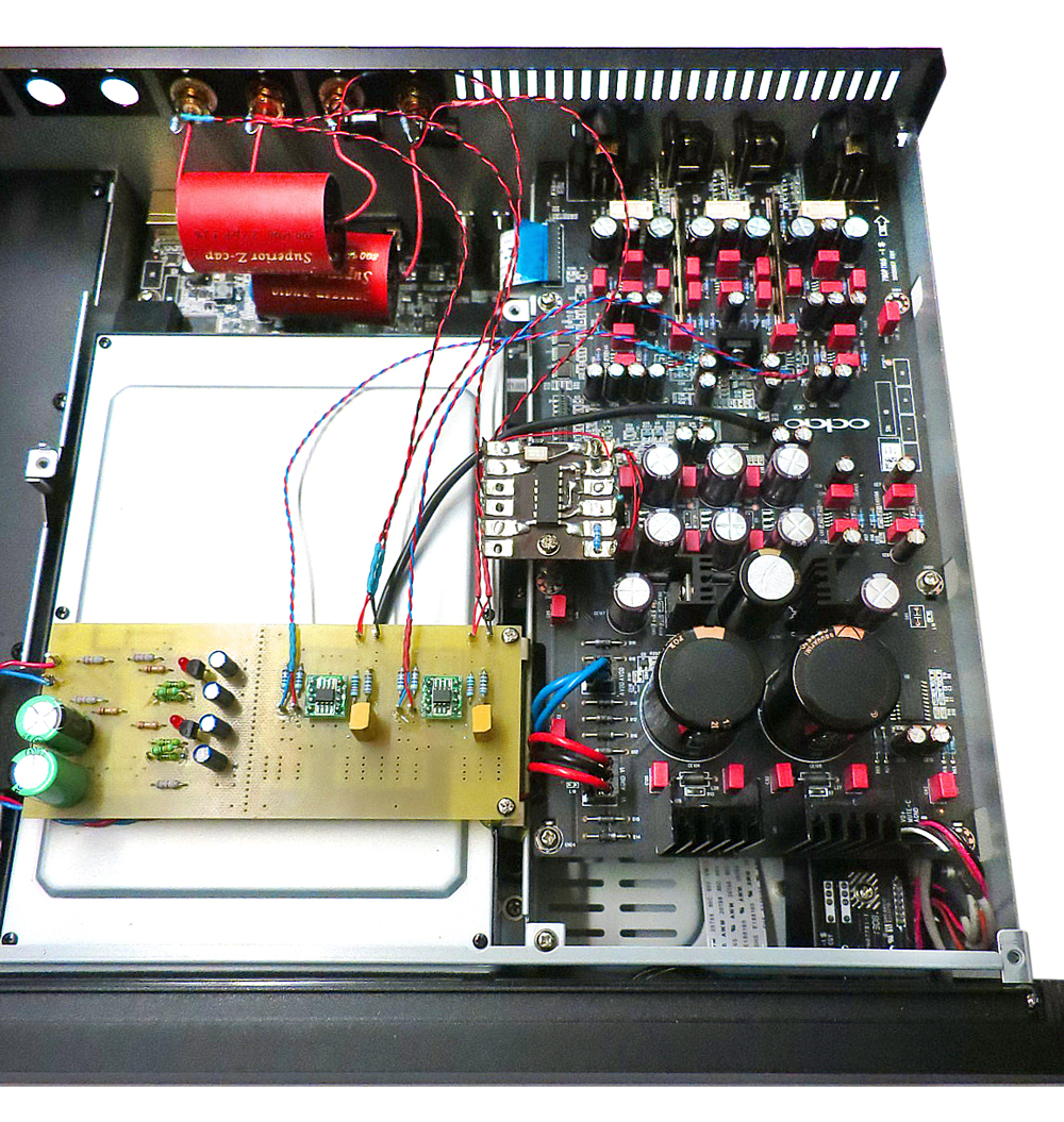

PART SIX
CONCLUSION:
I believe the above (more likely using using fixed 5V regulators), can be implemented on a new player without any hit to the bottom line.
Some final thoughts:
The R4 on the OTA is set to 10R and that means that the OPA-860 draws about 15mA each. Thought you might want to know that. The OTA is set to maximum current as 10R is virtually a short.
The R3 which set the DC on the output, this ideally should be a current source - and since about 220K can trim/null it altogether, that high Z it effectively is. The lower 15K could be split and a decoupling cap in between. But as is, it works and uses minimum number of components.
Later will try to do some distortion measurements.
I do have a fully balanced version of the above - two SOIC/OPA-860s required per channel and more symmetrical (has to be) than the above single-ended.
The single-ended unbalanced version discussed here, can also be used straight for the Multi-Channel Board - it would be a real treat.
It would be great for Coris to try the post-DAC circuit - the clocking part he is already familiar with.
I am quite pleased with the results, but won't elaborate and leave that for others to give fresh feedback and not pre-empt what they may say. Now that I have it running here, I hope to be able to play it for others in the near future.
I have done my bit - now it is up to others.
Cheers, Joe

Nice work Joe! This is a real contribution, I may say...
Just after reading your material posted here, I have two comments: I (personally) do not like long connections wires, even though it is twisted...
The other comment is about the clock frequency used. Is right that 54 Mhz it fits very well to be divided to get the clock for processor. But also the 108Mhz frequency it is dividable to get the 27Mhz clock... It is very known already that ES9018 act better (asynchronously) when about a higher clock frequency. The chip work like a charm at this 108Mhz clocking... I think one may forget such frequencies as 54Mhz, or 80Mhz...
Else, unfortunately I have stooped my work/researches on 105 (for a while), because I get very upset/angry about improvisations I faced all the time, and about quite poor equipped workshop I had. So I decided to make an real improvement in this direction before going further with Oppo 105 and some other things.
I will try for sure this idea about OTA post DAC processing, and I have to finish too, my unified clock project for this player. But, after getting upgraded my scope to 200Mhz, and put in place my new quite advanced soldering station, I have to finish also the focus servo/remote stage for my new microscope, I`m waiting for the tin feeding machines, and also I`m concentrated quite much for the time been on some many small but also important improvements in my workshop. Once those things finished it will make more easy and more productive my work in the main (modds) fields...
I agree, but for the sake of the exercise it was done this way. In principle (and in reality), the idea of generating a second clock frequency, this technique does work. As you have demonstrated too.
I doubt that Oppo would do it this way, I suspect they will stay with separate clocks/oscillators anyway. But they must get their act together and see that the 27MHz should be as important. The power supply improvement used in the '105 over the '95, for the Sabre DAC, should be at least duplicated for the 27MHz, and not just a cheap Xtal.
We have to look at Oppo's past practices to predict what they are most likely to do.
I believe you it works, but I can assure you, as a manufacturer, Oppo is not going to use 108MHz in a new Oppo - unless of course E.E.S. can assure Oppo it can be done. But I think that in reality 1) Oppo is not going beyond the 100MHz maximum for the Sabre DAC and 2) they will most likely want to do them separately. To bring that signal down from the Stereo board would also require a balanced line driver they use for the multi-channel board, to maybe make it work. No, I can't see them doing that - they just have to make sure they get that 27MHz right with no Xtal, decent supply and may be get Epson Toyocom to make a straight 27MHz SAW (or if not, only then a divider chip with 54MHz).
I have come across a link that indicated that some other manufacturer may go as low as 30MHz, as lot closer that the lowest listed 50MHz by Epson Toyocom. Doesn't mean a quantity carrot might not interest them.

Output caps
> I have also set up two RCA outputs via high quality Jantzen Superior Red Z 3.3uF
> so the Silmic can be compared. My initial reaction is that the Silmic is not so shabby.
I was planning on doing something very similar. Could you comment on the difference between the Silmics and the Jantzens?
Maarten
Maarten
The Silimics are not half bad. I can understand why they are liked in outputs of digital players by manufacturers like Oppo. They take the edge of anything nasty, are nicely rounded, their shortcomings are sins of omission rather than adding anything much negative. But the Jantzen gives you warts and all, so to speak. They won't hide anything and they have the edge in transparency - but surprisingly, the Silmics don't shut down transparency totally. They are 'pleasing' sound wise.
Cheers, Joe
