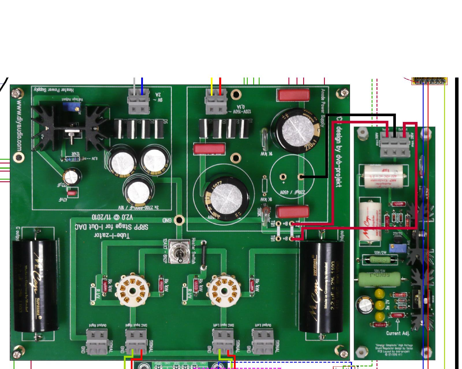

Anyway I have the tubes glowing as you will see, but I have a couple of questions.
When I adjust the output voltage from the SSHV to 150V as advised the input voltage is 160V, I read somewhere that there was suppose to be a larger difference between the two. The A/C coming from the 150V secondary is actually 154V.
On the SSHV the heat sink closes to the input/output is too hot to touch where the other heat sink is just warm, is this normal?
And lastly is it normal for the heater elements to glow brightly for about a second when you first turn it on?

What is your DC after the rectifier and without the SSHV in place?
Did you have a wire (the yellow one) joining tb1 and tb2 like here?
Otherwise only one tube gets the B+!
I had miss this on your picture here... 😱
326015d1359016650-tube-i-zator-professional-pcb-13-01-24-dq-dac-2-control-setup-4-part.jpg
No I seem to have forgotten the yellow wire😱
I will make changes tonight & report back.
