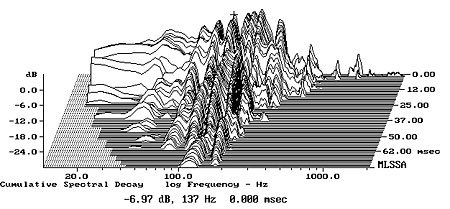

Harbeth Audio M40.1, cumulative spectral-decay plot

This is a perfect example for a big problem in HiFi: detecting an error (coloration) in the sound of a device (box) which reminds of something (wood, paper), and making probably false assumptions where this error comes from.
Please have a look at the measurements from Stereophile: Harbeth M40.1 loudspeaker Measurements | Stereophile.com
I don't know if this is the speaker you've heard but I bet that all of those Harbeth speakers are comparable.
The CSD of the back panel's vibrations looks awful, sure. But above 250 Hz there is no problem. BBC research indicates that these low resonances are less audible than resonances higher in frequency. But without a measurement at the listening position this CSD gives only a peek on the behaviour of the panels, so we cannot tell if these low resonances are below the audibility threshold found by the BBC.
If you scroll down a little you can see the frequency response of that speaker. Although I doubt the high bass peak (I'm sure that's an artifact by the nearfield measurement), you can clearly see a broad peak at 1 kHz. This peak is also visible in the measurements taken in JA's and AD's listening room (two pages further). This peak gives a coloration for sure.
And below, in the lateral polar plot, there is a broad dip above 1 kHz. This dip must be there, as the midrange is 200 mm unit. Again, here's a source of coloration, too.
Summary: there are two definitive sources of coloration (peak and dip), and one possible source of coloration (panel vibration). From this data it is not possible to assume that the "wood and paper sound" is from the panel vibrations. More likely it is from the peak at 1 kHz, and this can be tested by equalizing this peak.

Of course, you stood in front of them, listened to them, and heard a coloration which reminded you to the sound of wood and paper. Of course, the construction can be the cause.
But the available data tells another story.
