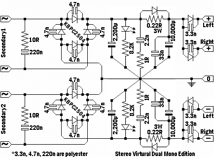

Perhaps a couple of photos?
The length of the umbilical cable can be as short as 1mm.

Your implementation of the diodes does NOT seem to be a practical approach, and I believe that the diode drop is reducing the PS rail voltage. Did you ever simulate the performance of the circuit with and without the paralleled diode and cap??? Remember, this is just the power supply. There is a tenuous connection to what you would actually "hear" from the amplifier, so do not do listening tests to "proof" your tweaks!!! :eek:
Out of the three you presented, the right most one has the most merit. I have recently realized that a single pair of caps can't offer the advantages of two banks of caps with a resistor in series with the rail in between to create a low-pass RC filter. Choose the resistor value so that the corner (-3dB) frequency is about 15 Hz and the mains noise and ripple harmonics will be strongly attenuated. In the figure, I am referring to the 0.22R resistor and the 10,000 uF caps. By the way, this is a pretty small capacitance for a PS unless the amp is only putting out something like 20WPC (for a class AB amplifier). If you are not sure what I am talking about, read up on RC low-pass filters, etc...
So taking your PS schematic:
Here are my suggestions:
  1. GET RID OF THE DIODES (to the right of the bridge rectifer... you might need those)!!!
  2. Where there was a cap in parallel with the diode, get rid of that too
  3. Don't bother with the snubbers on the diode bridge. The single series resistor in between the two banks of caps attenuates any diode ringing.
  4. Increase the 0.22R resistor to 1 ohm and use a wire-wound 5W or larger ceramic/sandstone power resistor. When used in conjunction with the 10,000uF cap, this gives you the 15Hz corner frequency I mentioned.
  5. Eliminate the 2.2n+1R snubber
  6. Do you really need LEDs for your rails? A PS is not a christmas tree.. but do use a 1k ohm 3W resistor to bleed the caps at turn off (or omit, they will bleed themselves eventually).
NOTE:the star as you have drawn it is OK with the dual bridges off of dual secondaries as shown. If a center tapped transformer with a single diode bridge is used DO NOT use a single star as shown. Instead, the first pair of caps must be connected with the transformer secondary at a single point, then a WIRE must connect this point to the point in between the second pair of caps, and that is where the earth ground should be connected and all grounds should return. This will restrict the strong current pulses coming from the diode bridge to the first pair of caps. I'm not sure why the other espousers of this practice (AndrewT, Sreten, etc.) have not made this more clear. It is important to note that you absolutely can not pull that off if there is only a single pair of reservoir capacitors.
