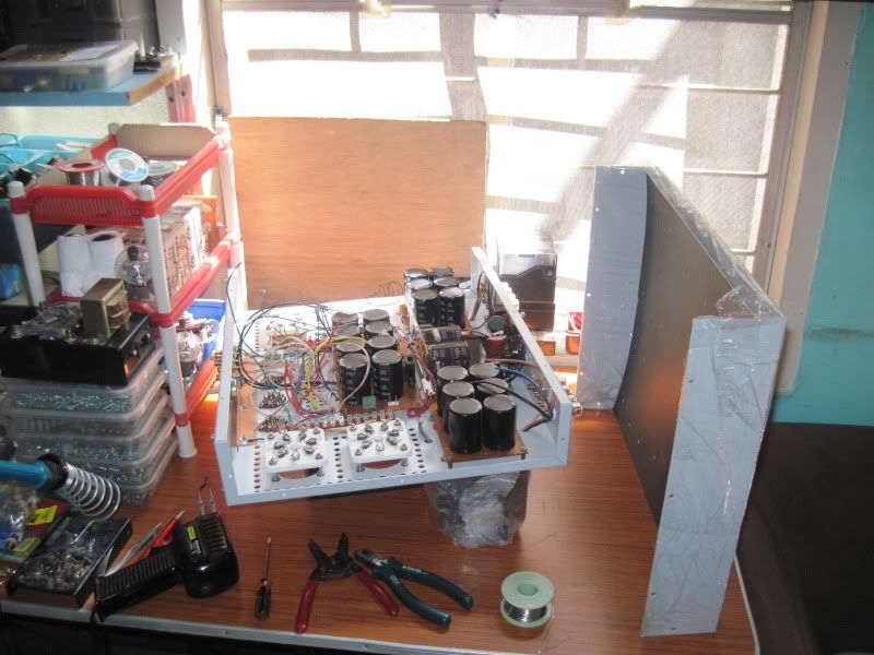

scitizen17 - sending PM. I like the chassis that you built. My metal working skills probably wouldn't be up to steel though.
The steel chassis I used was by way of what I had available. I would not recommend it if you had a choice. Very difficult to deal with. But hey, at the end of the day, it worked.

My board and Mouser parts got here today. As soon as the kids were in bed I stuffed all the resistors and diodes in.
