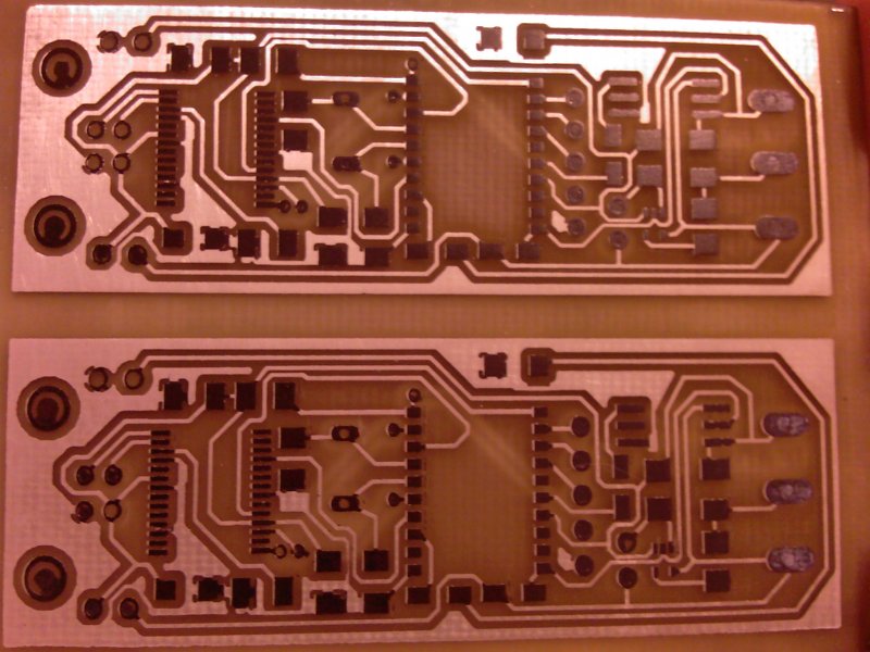

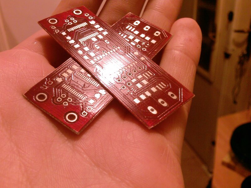

I have found out that Pebeo Vitrea can be easily masked with the toner transfer method.
Masking:
Painting:
Removing the mask after cooking:
Basically it works as a solder mask (doesn't burn away), but I can solder it through if I really-really push the soldering iron into it. Have you also experienced this, or was it only me who didn't bake it enough? (I didn't have a thermometer to measure the temperature with)

Re: masking
You just need to bake it at 180C, then it will won't melt later, unless you do something real unfortunate.
Wow ! Good idea
Can you explain wow do you remove paint/toner over pads. Just by heating ?

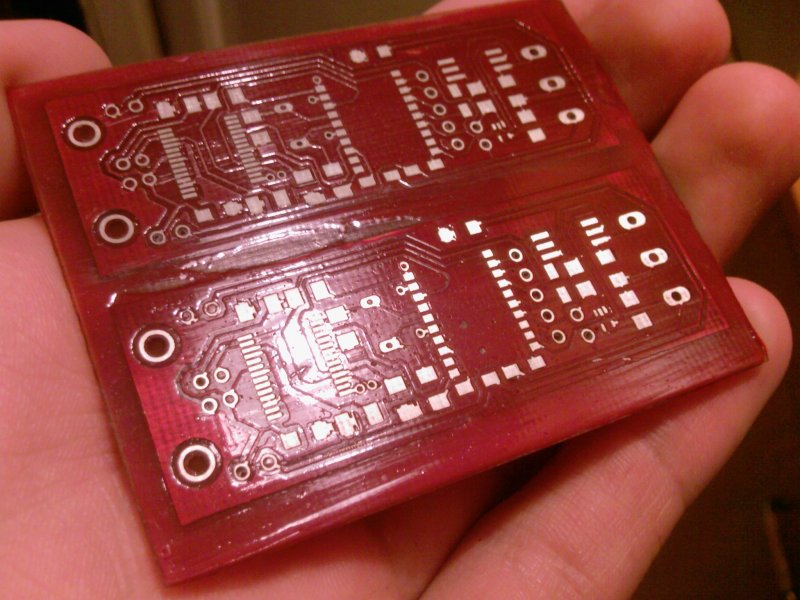

I'm using cheap shiny paper and a simple laminator for the toner transfer. It's possible to achieve a stable 6 mil resolution this way, like in the image I have attached. I think in your case the uneven blobs appeared because you didn't let the paint dry for long enough before baking it (it requires 24 hours).

I think the glue caused the problem. With toner it worked very well. The pads became a little bumpy after baking, and it was easy to remove them. I baked the board again after the acetone treatment.
