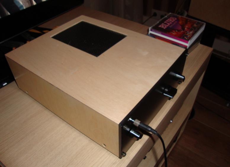

I am going to compare the TK2050 to the UCD180.
My wooden class D amp has a 24bit DAC and Digital voltage winding and analog + and - voltage for the analog part.
I just added extra windings to my toroidal transformer.😀 Works perfect. Cost 3 meter copper wire round 0.5.

The DAC 24 bit integrated in ucd amp.
See extra windings on toroidal Digital 5V an symmetrical power op-amp.
On backside near speaker output SPDIF connector. On front side optical input .
You certainly did manage to squeeze it all in tight.
David
"Tight" is the word.... 🙂
Here a really tight build I did once, ICEpower 125ASX2 module in a very small 1U box.
David
Yeah I thought I would have plenty of room but it became fast full inside the wooden-box.
It has a headphone output speaker A-B-AB- headphone switch, 24bit dac coax optical input.
24 step accurate volume control. All film capacitors. 2X 180W amp with 500VA power supply.
Next step is a Riaa preamplifier with input transformer.
