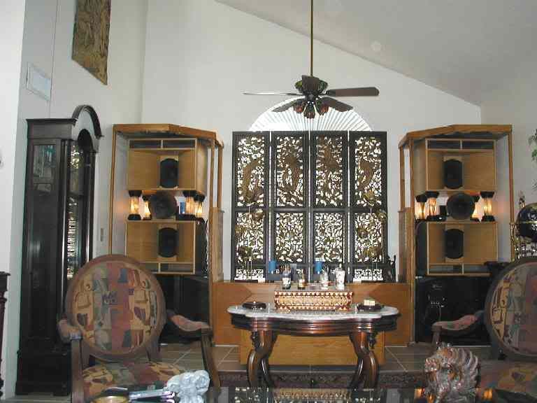

Our compromise looks like this .I said " Honey , I know that you love me so much that I can put any speaker I want in the living room. BUT You know that I love you enough so I won't put anything , which you find unacceptable 😉
- True WAF speakers
