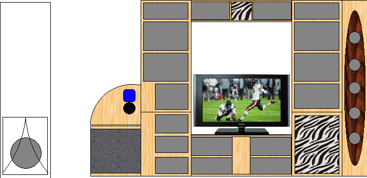

Here is a bit of a concept that I was tossing about a couple of years ago - never did get around to it. Go figure - a DIY type having a few ideas that they never seem to get around to playing with? 🙄
The left side of the enclosure shows a "fold out" OB type speaker with a separate woofer enclosure. The right side shows a line array design with a "tapped horn" woofer hidden behind the bookcase.
Obviously you would want to match up the speakers when building one - unless you have rather odd taste in mixing and matching speaker types.
SHMBO desired speakers that would only be 42 inches tall (107 cm) – so back to the drawing board. After that I lost interest in any father pursuit of the project. 😡
