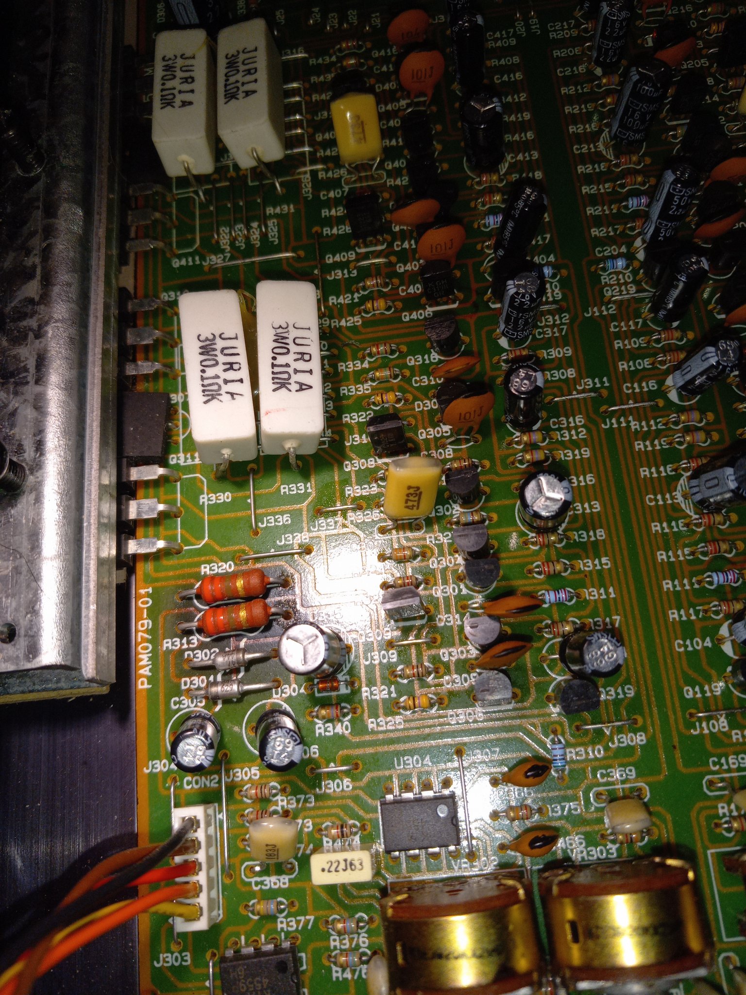

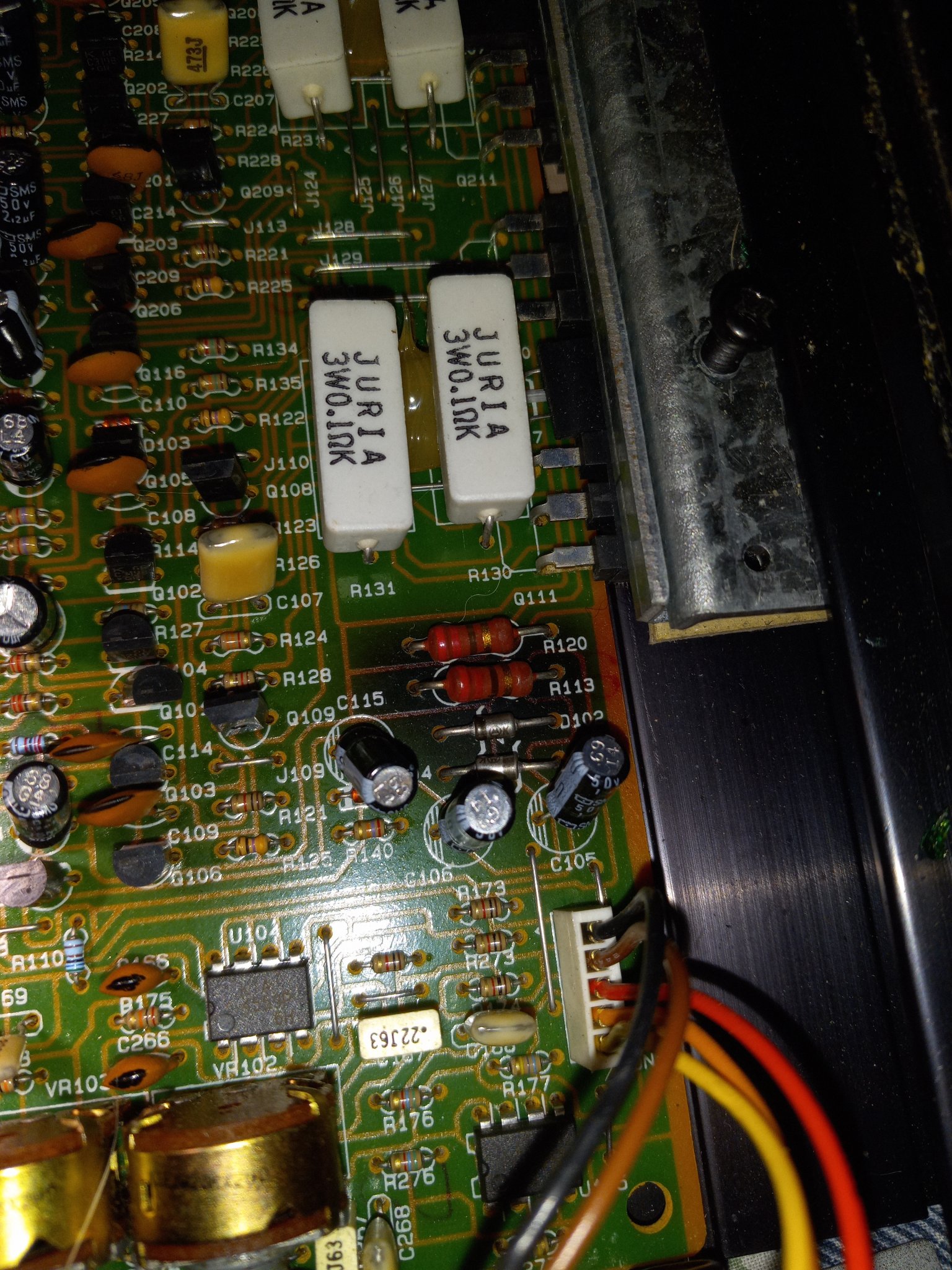

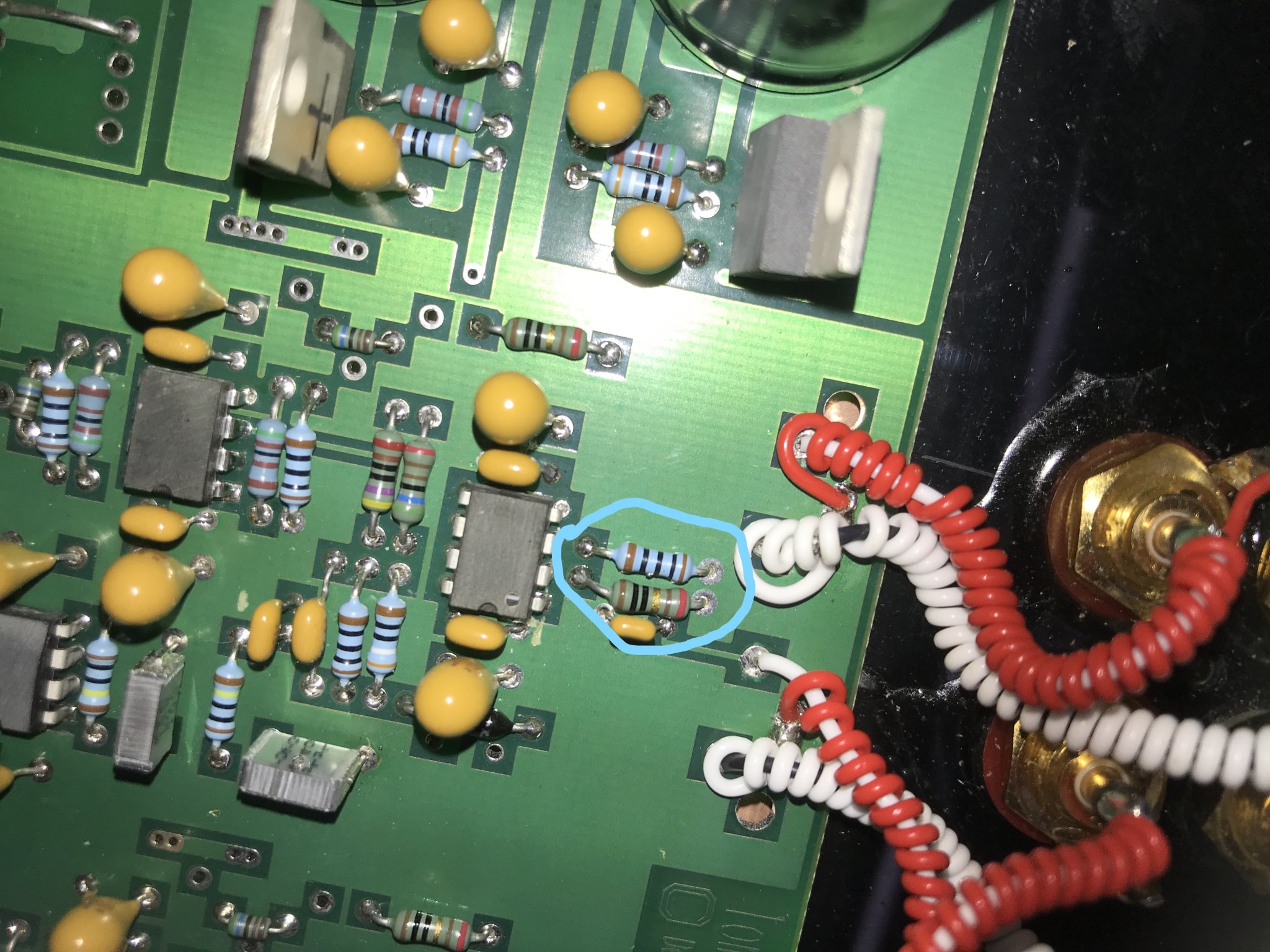

I have a Cyrus One issue 07 TOG. I checked the bias recently and I have a channel measuring 5/6 mV. The other channel is ok measuring 8mV.
I have the service manual, and so I read there that if the value is low you must put a 220ohm resistor across the R81/R82 (This resistor should be 130ohm if I remember right).
Well, the strange thing is that on my unit the R81/R82 are those kind of jumper/resistors...here is a pix...
http://img857.imageshack.us/img857/5513/img0563vf.jpg
...if I check these resistors with my DVM i read 0....
If I put the resistor across the pins...nothing happens to the bias...
Anybody has the same issue as me?

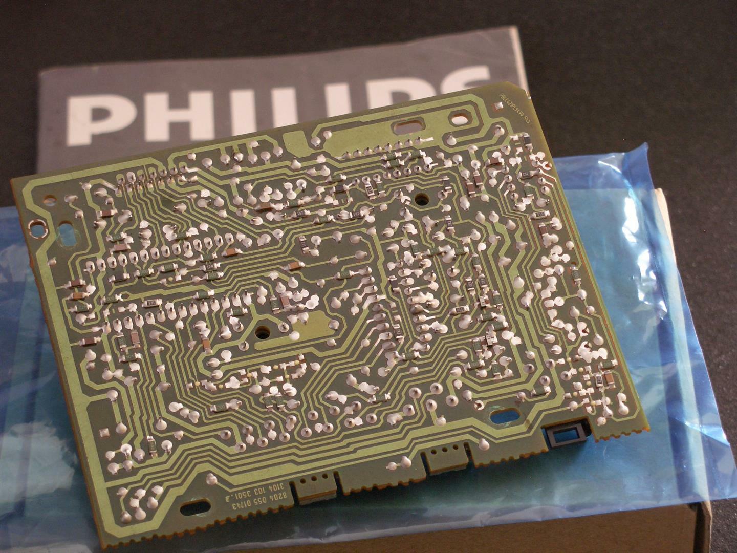

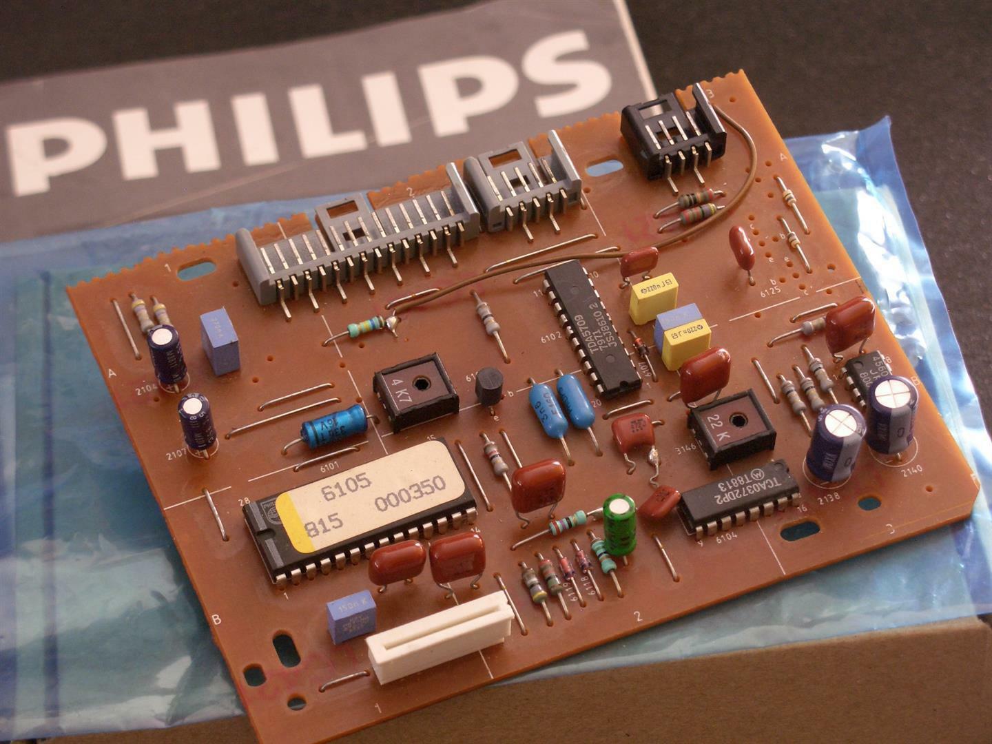

Philips CD Servo PCB "3104 103 3501.2 / 8204 055 01742" in which Models in use ??
I am looking for CD player models from Philips/Marantz, where the above mentioned servo unit is in use.
The only model, that I have found from Philips is the CD-670 - go to
http://egirland.blogspot.com/2013/03/again-on-philips-cd670-and-cdm2-cd.html
In the meantime I have find out, that this PSB's can be only recognized by the 4-digit number on the attached sticker mostly glued on the surface of TDA5708 and not by the above mentioned PCB numbers - check out the attachments in post #29 under
https://www.diyaudio.com/community/...that-use-cdm-2-cdm-4-transports.372412/page-2
Unfortunately from several PCB's sticker with this number isn't longer to find.
Thank you in advance.
