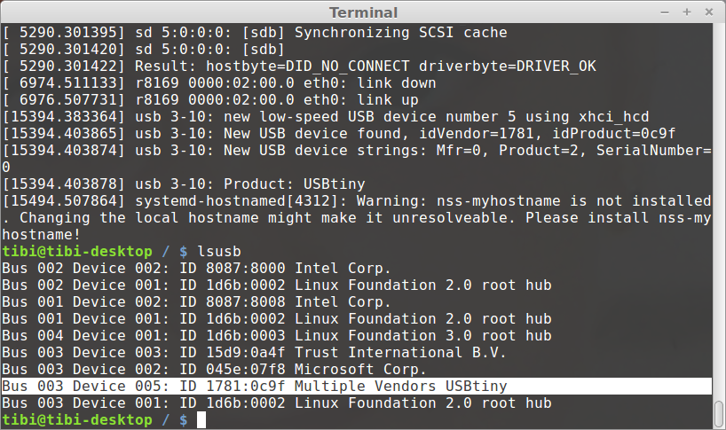

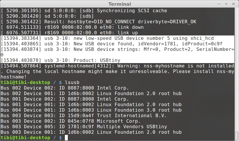

- check if USBtiny is properly detected by OS.
Type "dmesg" and press enter
Type "lsusb" and press enter
You should see output as per below images.
