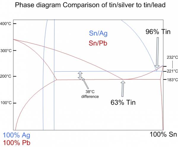

This is an overlay between eutectic tin/lead and eutectic tin/silver. The red lines are for tin/lead, the blue for tin/silver. The left hand side of the diagram is where the alloy is zero% tin, and the right hand side is where the alloy is 100% tin.
