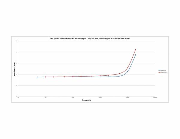

This is the resistance sweep of the mike cable coiled as a solenoid, only the pin 2 wire is being used here. Note the dissipative resistor increase due to eddy currents in the stainless cylinder.
