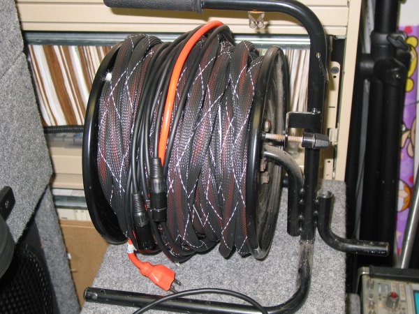

Here is a snake I made using a 100 foot extension cord, a mic cable, and a stereo single ended line level cable. I wrapped the cables around the line cord and braid sleeving over the entire cable. This configures the cables as per option C in the system ground layout options drawing.
