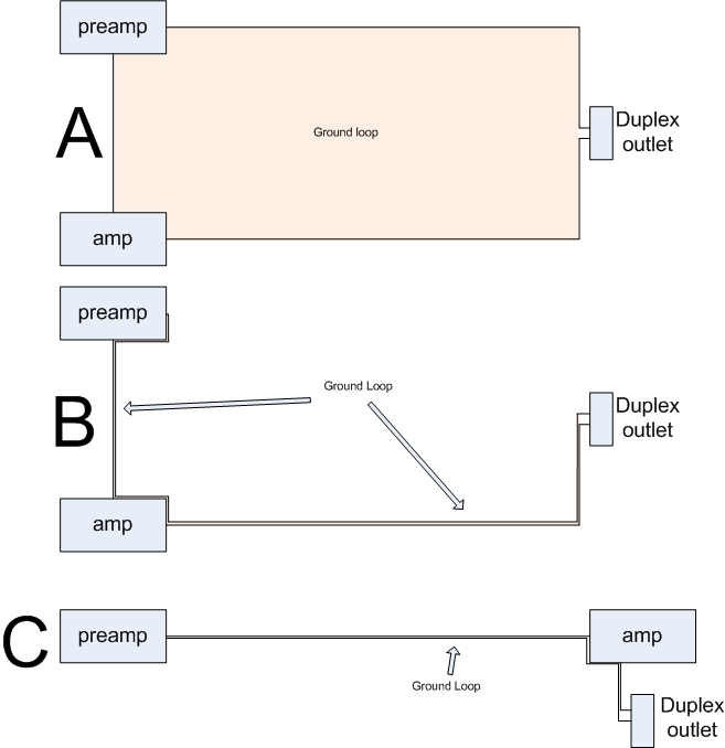

Here are three cordage options. A is most sensitive to ground loop trapping. B and C reduce the area, so eliminate coupling to external magnetic fields like hums, buzz, clicks. I wrap the IC's around the PC's.
