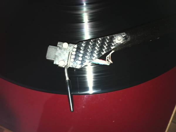

home made tt with 13,25 inch carbon fibre suspended tonearm

hi to one and all hifi nutters out there like me. im a newbee here and i hope you dont mind me posting my DIY TT .My tt is made round a linn white bearing and main shaft inner and outer plater as well as thorens td 160 s inner and outer platter inverted and bonded to each other tt base is a combination of mdf 8mm top and bottom with mica surface chip board in the middle all bonded together also used for the arm base arm pillar is mahogany head shell is also carbon fibre wired with sillicone silver litz suspension is damped
with wynns stop smoke also it has a neodinnium magnet in the pot,the motor is from the td169 i found the linn had no torque belt is 800mm from audionote.i hope you like it thanks for looking.if you guys have any Q's dont hesitate or for that matter crits also wellcome
