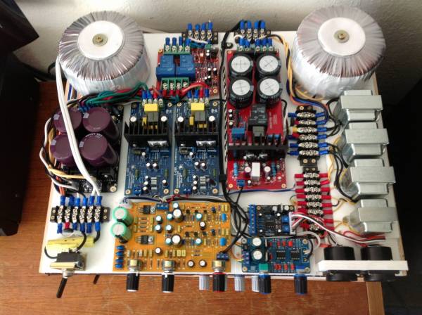

Here's that 2.1 system using L25d's and an AUD550.
L25's give very low distortion for Right and Left, 200 watts per channel. AUD550 gives OK distortion for subwoofer channel at 400 watts. Toroids give 72 volts DC after rectifier so a couple resistors should be changed on AUD550...
Anyway it works great!
