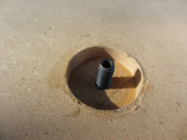

There's a 1/8" ball bearing glued into the cup point of the set screw. This can adjust the pivot of the turn table above or below the center of gravity of the platter. Setting the platter high and pretty much unstable makes it easy to see where to add weights to balance it.
