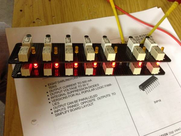

21 relais:
7 standard takamisawa, they control 14 nais latching relais with single coil.
--> no hum and other bad things on in/output, because after switching there is no voltage on the coils.
