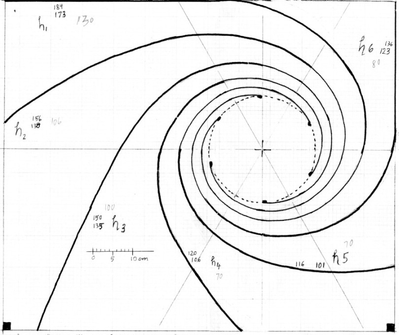

six horn Cornu for a 12" driver

This is the complete drawing of the two halves published before. Unfortunately in the process I lost the underlying grid structure with 1cm squares.
I tried to make the horn throats at least 2cm wide.
The drawing as is is for the left speaker. I reverse the drawing horizontally for the right speaker.
