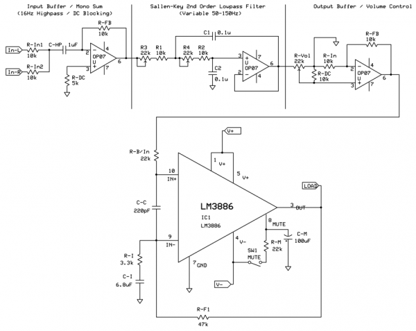

Input buffer with mono sum to Sallen-Key 50-150Hz 2nd-order variable lowpass filter to volume control to output buffer to LM3886 amp. Approx. 40W at ~6 ohms into a Tang Band W6-1139 6.5" subwoofer.
