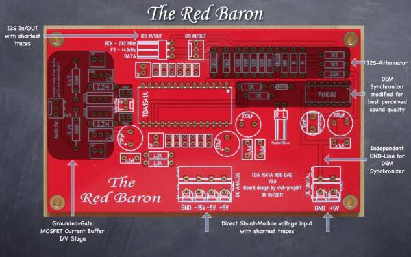

The evolution changes:
- Direct shunt voltage inputs with shortest onboard traces - I2S In-/Outputs with shortest onboard traces - Upgrades DEM Synchronizer - Onboard Grounded-Gate MOSFET Current Buffer I/V Stage (-ecdesigns- MK7 version) - Compacter design Still on the module - Separate GND-Trace for DEM-Synchroinizer - Master/Slave connectors for parallel DAC module usage and external I/V Buffer stages e.g. Tube-I-zator & DDNF Stage - Groundplane - no SMD Design |
