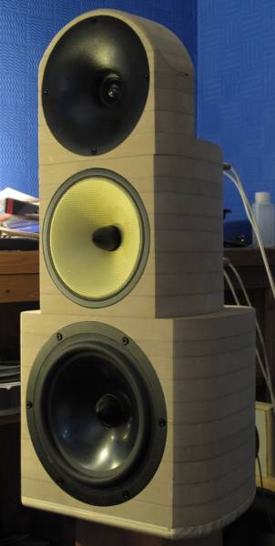

How I am using the driver. A Scan-Speak D2608-913000 tweeter (what was the peerless HDS tweeter) in a Monacor WG300 wave-guide with an RS225 on bass. All sealed trans-lam cabinets and crossed over actively using a DSP.
