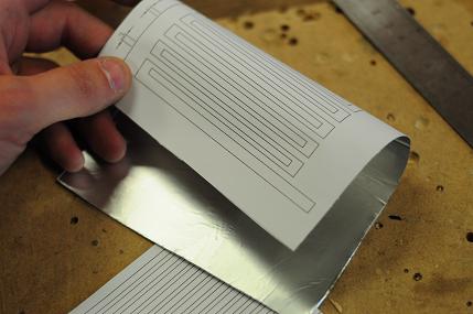

Sainsburys basics range kitchen foil lightly tacked to a paper pprint of the CAD drawing of my circuit patten.
3M adhesive spray used, this needs to be removed so spraying was from 18" for less than half a second.
